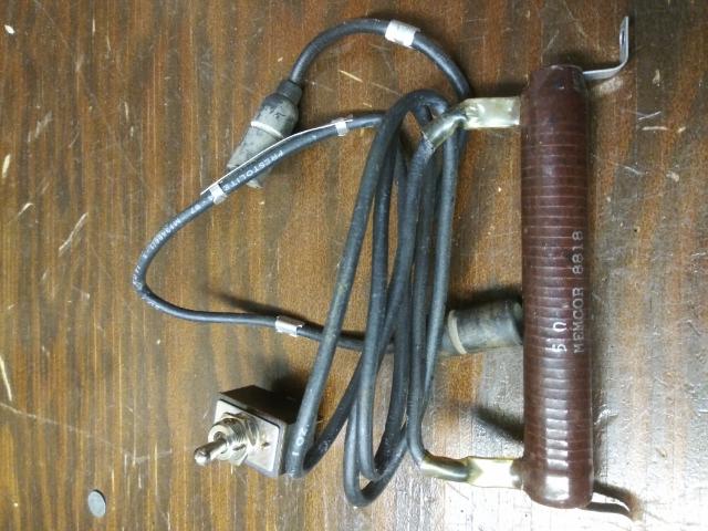

The two speed toggle is just a SPDT center off switch. Hardware stores sell them. If Saturn Surplus is still open, he has the waterproof versions. Speed is controlled by a sand-cast high current resistor that is a bit harder to come by in today's world.

This is all there is to the two speed fan.

You can go the resister route which builds up heat in the motor winding or you can be nicer to your DC motor and use a speed controller.
