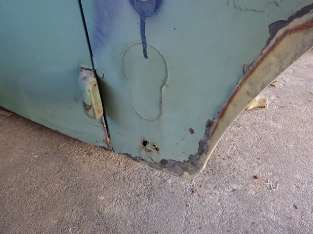

Anyone know what the knockouts are for on the lower right side of the cab? the knockout is both on the outside and the inside- in the drivers compartment.

I believe those knockouts are for the Power Plant Heater Kit, p/n 7387275 (also referred to as the arctic heater kit). I have one (or parts of one with some duplicates...), but have not yet tried to install it.

I also have (most) of that kit but after looking at it closely, I'm not sure I want to cut up my truck that much. Other pages of that install manual show the right fender mounted fuel tank that feeds the system. It to needs holes drilled into the right fender to be mounted. The unicorn of the whole setup is the 3 piece fitted insulation blanket that goes on the hood and side panels made specifically for the M37. (pictured on the cover of the manual). Early kits just used the ill-fitting WC blanket. Radiator blankets were part of it as well (also part of the left fender personnel heater kit), but they are still relatively easy to find.

It's a pretty neat set-up for sure. Nothing is wasted. Heated coolant circulates through the vehicle's system and is also routed under the batteries to keep them warm. Even the "exhaust" from the heater is routed to the shroud around the oil pan. After that, is rises around the motor. Gotta keep that 30W in some kind of liquid form.
