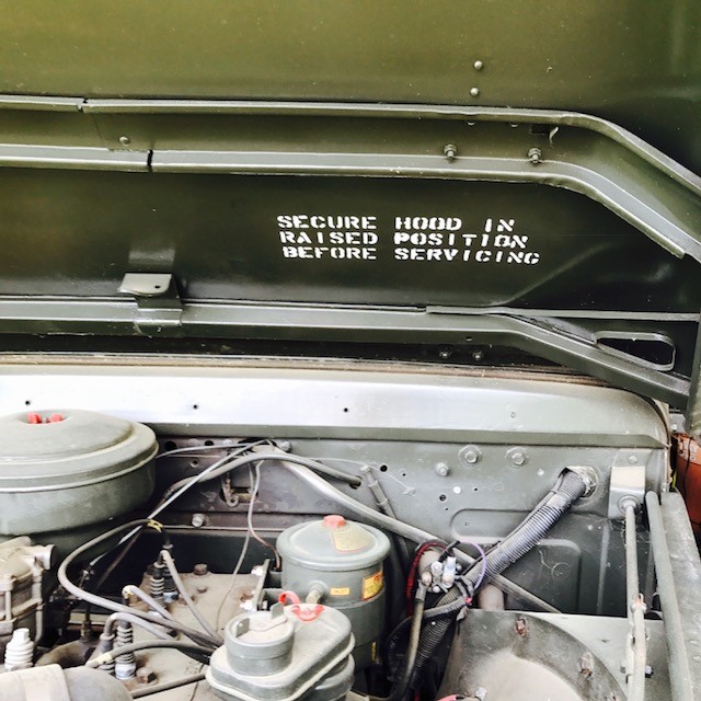

TK, Were there any markings under the hood, such as, disco batt or anti freeze calculations?
Re: M-43 Air Force Ambulance
Hi M-37Bruce. Markings under the hood? Well.........sort of! There is the usual stenciled warning about securing the hood so it doesn't fall on you. The batteries are under the passenger seat inside, and there were no markings there, but I will be installing new ones with what is appropriate. As to the coolant (anti-freeze) yes, there was a calculation.....hand written on the radiator shroud, stating the date, and the level of protection on that date, which the last writing date was 1980. It was protected to zero!
I guess I better take a few pic's of mine?
- Secure Hood 2.jpg (112.76 KiB) Viewed 11166 times
