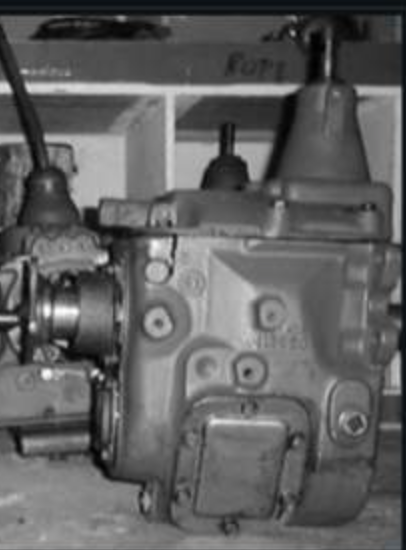

I will be scraping off 50 years of grease and mud off of my transmission in the AM. This being a 1963 M37, I am expecting it to be a 420 model or an 88950?
On this tranny, is the PN cast into the case on the driver's side? Vehicle shows 66k on the clock, and during the tranny fluid change, there was lots of silver colored metal that poured out of the drain plug.Vehicle needs to be shifted slowly, I always double clutch through the gears. It will hold in any gear that it is shifted into. I have the feeling my tranny jack will be getting used soon.
- Screen Shot 2018-04-08 at 8.10.57 PM.png (215.45 KiB) Viewed 4852 times

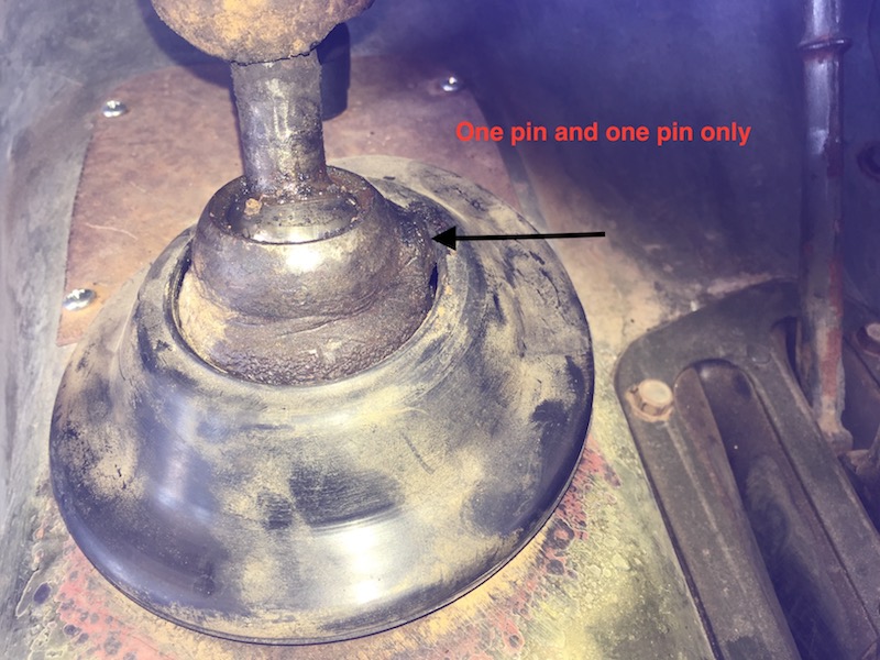

Look at the top of the shift tower:
One pin on the right side, it's the old one.
Two pins, one on each side, it's the new one (NP420).

Re: 1963 M37 4 speed transmission ID
I see one pin on the right side of the shifter
Sounds like you have an 88950 trans.outpostm37 wrote:I see one pin on the right side of the shifter
These are NP420 mainshafts, but here's the sort of damage to watch for.

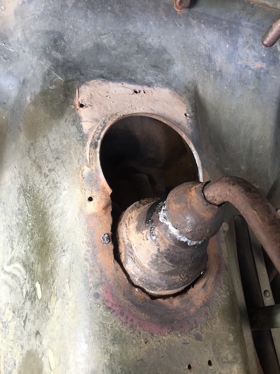

Here is the tranny hump in my 230 flat head powered M37. Engine is the military version. Tranny is .... who knows.
Is it possible I have a tranny hump off of some other style of m37 version?
The Canadian trucks used the Chrysler/DeSoto big-block flathead six and a different transmission, but I believe that the engine was moved forward in those trucks, so I don't think that the center floorpan section was different.
The shift tower in your truck does not appear to be from an 88950 or an NP420, or at least not from one of the military versions, which use a stub shaft and a removable shifter cane.
If I were to guess, I'd say that you have a different, non-standard transmission, based on the appearance of the shift tower/shifter cane, and on your comment about the short throw into 4th gear. The shift tower shape sort of looks like one of the two early, non-synchro civilian Power Wagon transmissions.
I bought an m37 a couple years ago that had a non-synchronized transmission from a civilian power wagon. The floor pan was cut just like yours and the shift lever looks similar as well.
