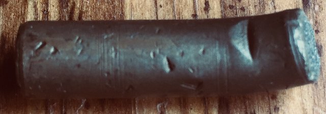

Guys,
I am replacing the fluid in my M37 tranny for the first time since purchasing it and I always check inside and feel around for chunks. I discovered a one inch long chunk of a copper shaft (see photo). It does not look like a tranny part. Looks more like someone used a copper drift as a lever and busted off the end. Can someone familiar with the innards tell me if this is anything to worry about?
Keyslammer
Update: NOT copper, steel...and 0.312" diameter about 1.2" long
Keyslammer
- broken synchro pin.jpg (30.04 KiB) Viewed 3865 times

Finding a piece of metal like that in the bottom of a transmission would make me concerned. When was the last time the trans lube was drained? Have you noticed any issues, noises, etc. with the transmission? At a minimum, I'd want to remove the top cover (the shifting assembly) and have a look at all of the gear teeth.
Which transmission are you running: 88950, NP420, or Canadian? Does it have a PTO attached?
Are you sure the mystery piece is made of copper?
Both ends of the mystery object look like they've been chamfered, which would suggest it was not broken off of a longer piece.
About the only thing I can think of that's close to the shape and size would be the gear shift rail interlock pin 7373633.

That does not look like copper, copper would not normally stress crack like that where it bent. That looks like steel and steel that had some serious force on it. You need to sand a portion of it and also use a magnet to see exactly what it is to get a better idea of where it might have come from.

Pin 7373633 is only 0.185 x 0.525 long, looks bigger than that to me. But could it e 7373634 (plunger reverse shifter shaft)? How does your shifter feel going into reverse gate? Can you measure the diameter? It looks like 0.375 to me but hard to say. There aren’t many things in those gear boxes that look like that. Any issues with the way the transmission works?

I wondered if the interlock pin was too small, but I didn't see any evidence of the C-clip groove to suggest it might be the reverse plunger shaft.Marmalute wrote:Pin 7373633 is only 0.185 x 0.525 long, looks bigger than that to me. But could it e 7373634 (plunger reverse shifter shaft)? How does your shifter feel going into reverse gate? Can you measure the diameter? It looks like 0.375 to me but hard to say. There aren’t many things in those gear boxes that look like that. Any issues with the way the transmission works?

Another possibility would be one of the pins NP-88477 from one of the synchronizer stop rings.

I'm betting Elwood is right. That was what popped into my head when I saw the initial photo. Looks like time for a tear down

Yup, that sure looks like it. Has anyone seen these shear before?

I've never seen a synchronizer stop ring pin shear before, but I suppose if someone put too much pressure trying to shift, or was leaning on the shifter cane all the time, it might fatigue one of the pins where it narrows down.

Can't recall ever seeing one sheared off, but have seen MANY that were loose where they are braded into the stop ring and could have easily become dislodged from it.

Ok...I think I was blindly hoping it was a copper or bronze piece left behind when tapping something into place. I had to go out to the garage and get my Magnetic pick-up. Sure enough, this is American steel. I think you nailed it...it looks like the synchro pin you have a photo of. This is 0.312” in diameter and 1.13” long. I am guessing the color is from its extended time in the gear oil (sulphur). The photo doesn’t show the color well but it is identical to the patina on my 50-yr old brass drift set.
So, I’ve not noticed ANY odd shifting or synch issues between 2nd and 3rd. Tranny runs smooth with no noticeable hitches. There are no other “tooth” or gear pieces at the bottom of the tranny. Clearly, you have had more gear-time than I have, so this now becomes a question of whether this is a serious problem (gears coming apart, shattered case, etc)...or merely a note for what I will need to do “when I get around to it”.
This synchro pin shows where it got “bent” against another face (photo attached).

The damage to that synchro pin (or whatever it is) had to be caused by it being crunched between moving parts, which in a transmission means gears. I'd be surprised if, given the amount of damage it sustained and being steel, that it didn't damage any gears.keyslammer wrote:Ok...I think I was blindly hoping it was a copper or bronze piece left behind when tapping something into place. I had to go out to the garage and get my Magnetic pick-up. Sure enough, this is American steel. I think you nailed it...it looks like the synchro pin you have a photo of. This is 0.312” in diameter and 1.13” long. I am guessing the color is from its extended time in the gear oil (sulphur). The photo doesn’t show the color well but it is identical to the patina on my 50-yr old brass drift set.

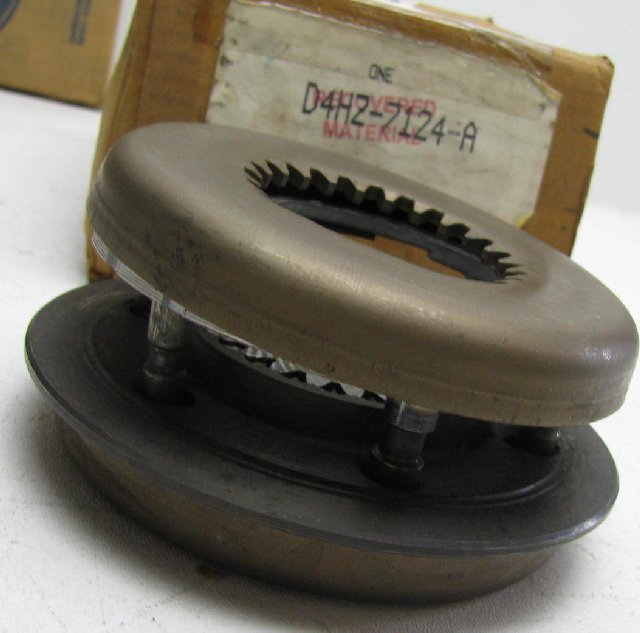

I've found a synchro for the NP435, but don't have a p/n reference to validate this against what I have in the NP420. This is the p/n, and it looks like this was used on early Ford trannys (?):
Ford NP435 3-4 Synchro Assembly, part number: D4HZ7124A
This looks like a better route to go than the older version of the synchro if it is a drop-in. Considering this project, I think I may purchase a rebuilt tranny...swap mine out...then rebuild mine over time. That will keep me on the road and give me time to ignore yet another project. I appreciate your insight and direction on the TM's too. It will be interesting to see what I find inside the case.

There are some differences in the version of the NP435 made for Ford such as input gear shaft diameter and bearing design, but I don't know Ford stuff well enough to say if that synchro assembly will work, sorry. Nor do I have a cross reference for Ford parts to know if that p/n is correct.keyslammer wrote:Elwood,
I purchased some transmission parts as a lot once, including an NOS synchro assembly that was supposedly for the M37 NP420, only to discover after I had installed it that the thickness of the synchro assembly was not correct, and I couldn't get the shim adjustment to set up correctly. So I had to remove the main shaft and input gear again, and order a correct synchro assembly. I still haven't figured out what that odd synchro goes to.
Good plan, but if you're buying a rebuilt trans, get it from someone who knows these transmissions, does quality work, and stands behind the product. With a closed case, there's too much opportunity to use inferior parts or skip over some of the time-consuming steps such as shim set up, knowing that the end user will not know the difference until too late down the road. If I didn't do my own transmission work, I wouldn't hesitate to buy one from Charles at M Series Rebuild.Considering this project, I think I may purchase a rebuilt tranny...swap mine out...then rebuild mine over time. That will keep me on the road and give me time to ignore yet another project. I appreciate your insight and direction on the TM's too. It will be interesting to see what I find inside the case.
Charles' comment about the nylon inserts (NP p/n 93549) on the 3rd and direct drive shift fork has certainly been my experience, too. I think I've found maybe one intact nylon insert, the rest have just disappeared, likely ground up by the gears and drained out during the next lube change. The odd thing is that these inserts don't appear in the ORD 9 SNL parts listing or in the later NP420 manual, so maybe they were a mid-production change by New Process Gear - if your 3rd and direct shift fork has small horizontal cuts in the fork ends, and the vertical cuts of the fork ends seem oversize for the thickness of the synchro sliding clutch, then you're missing the nylon inserts. I think VPW sells them, but you can also get them (and NP435 parts) from places like Novak Conversions: https://www.novak-adapt.com/catalog/tra ... 435-parts/
