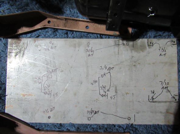

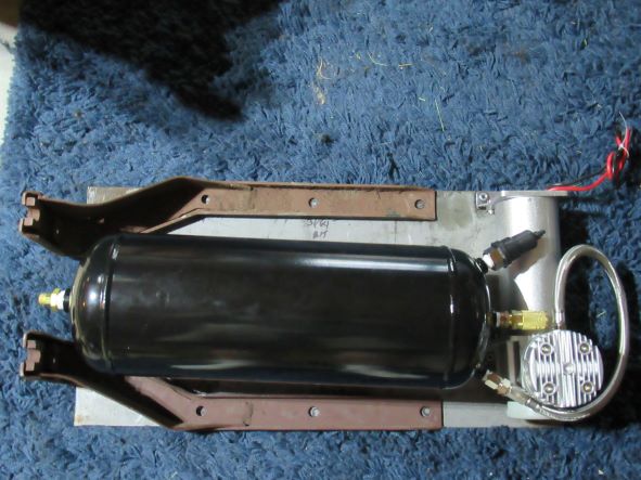

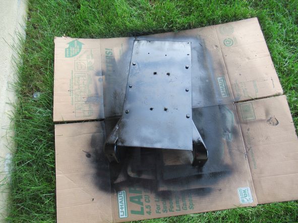

Reviving this old post because I'm making some headway on my air horn kit. I fabbed up the tank/compressor mount using two of the front fender hangers ( I had a spare pair). I measured, marked, drilled, test-fitted then painted the mount black since I'm out of 24087. In the pictures you will notice I used the mounts with an outward stance; I can also reverse them for a closer mount point but until I get under the truck to see how much frame space I'll have, I'll leave them as they are.
Notice that I also took advantage of the extra bung to mount a quick-connect air fitting. That might come in handy in a number of ways.

Tried to fit this over the weekend. I don't like the placement on the frame so I'm exploring options. it appears I can mount this pointing backward from the back of the cargo channel; however that would mean mounting the tank and compressor on the bottom side of the plate-not an ideal setup either.
Giving this some more thought before proceeding....
