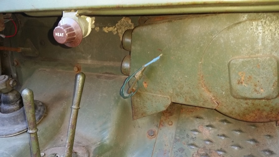

Anyone know which heater that is in it? From a Jeep?
There is an old heater of some kind that doesn't work, I didn't know! We drove it around a back road, lots of fun, I can't wait to get it all sorted out. The engine is fine, we have other stuff to do though!

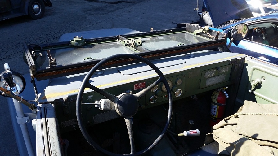

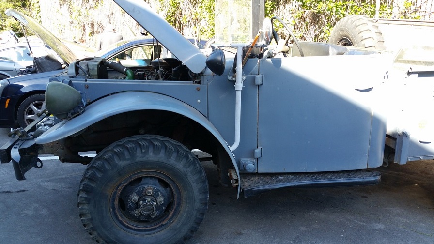

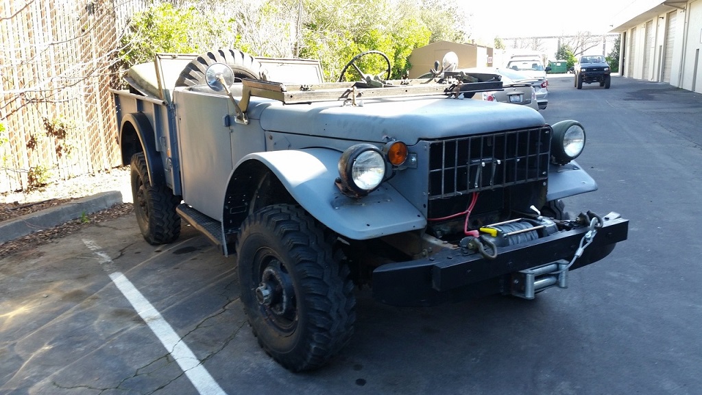

Hey Morgan
That looks like a dandy M37 with some interesting options too! I like the side spot light!
Plus, seeing the rear placed windshield,it looks like it might be the very rare “dual cowl phaeton” M37! :D
Looks like fun to me!

Yeah it is pretty crazy to drive, this one has a rebuilt engine etc. so that is all good. Mostly paint and details to work on. Yeah he had the spotlight mount made from schematics from this site I think he said, had a guy fabricate it.

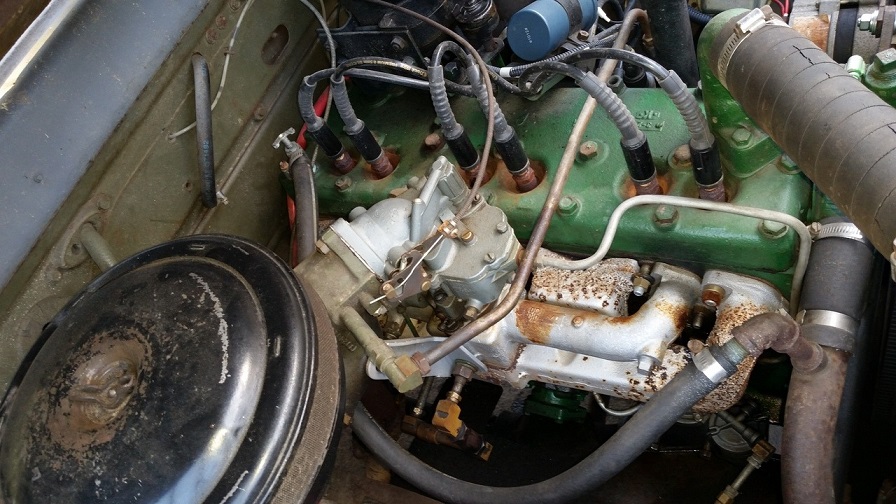

I'd move your fuel line outside and away from the manifold. You are just asking for vapor lock having it routed in there like that. Typically, where your fuel line is currently routed, is where they route the vacuum boost line from your fuel pump to your windshield wipers.
But yeah, they are fun machines! Yours looks really nice.

Thanks for the tip, I will talk with my friend/mechanic about it tomorrow. The truck has been worked on slowly for about eight years, most of the body work is done, minus inside the bed basically. Probably doing 4.89 gears in the summer, I bought them and waiting for them. He put real rebuilt Warn hubs on it, yeah there isn't really any real rust, just some light surface stuff in a couple places and the muffler. He painted the frame and did the body work a couple years ago, tires are pretty new.

Might want to replace those radiator hoses too.

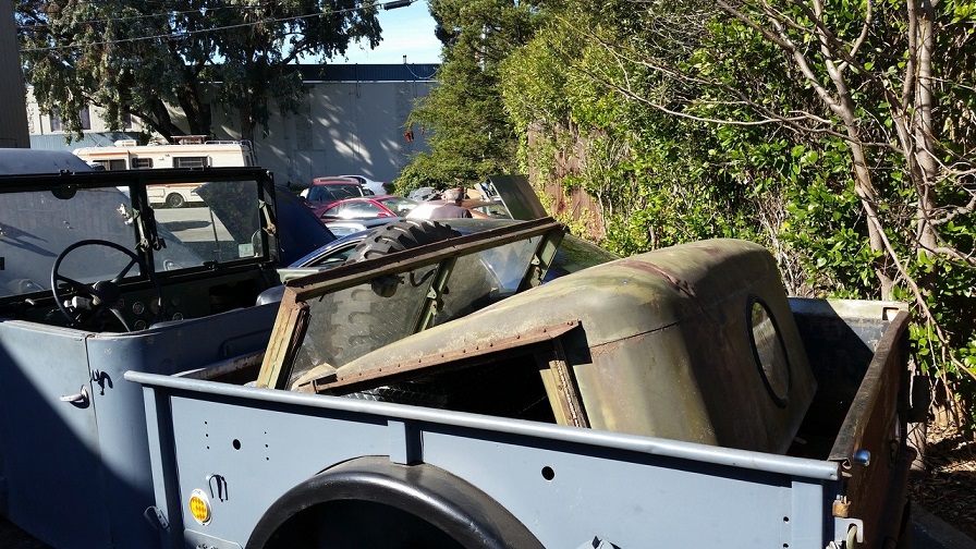

Oh a new radiator is in the back of the truck, that will be changed. It just got here from MA. Oh you are in Utah, I would love to drive this around some of those spots out there.
