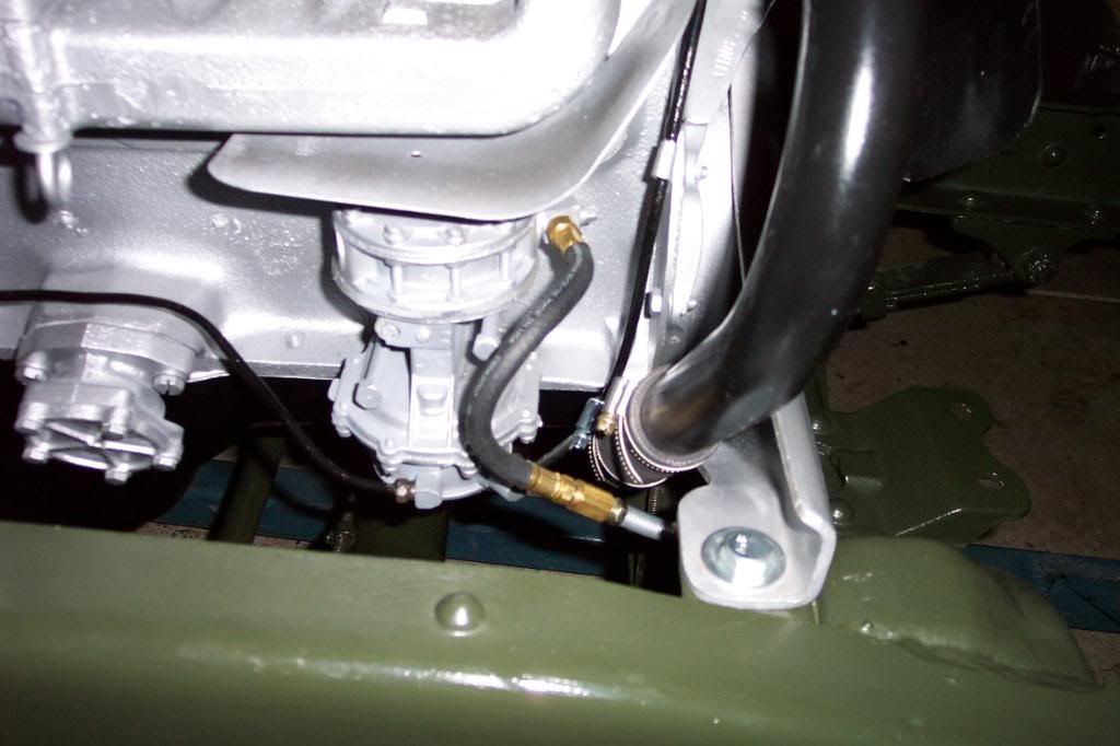

My motor has a civilian style fuel pump on it. I am going to try to rig up some sort of heat shield for it. Is this a stock part and does anyone have a photo?
I still can't understand why I just started having this problem. Have I just been lucky these past couple of years?

The heat shield mounts to the top of the pump but the line running from the pump to the carb is near the manifold. Ideally, there should be a heat shield between the manifold and the line, but maybe the air gap is enough? As a last resort, shielding the line might be in order but I think we'll wait until a summer heat soak to guess.

My truck has an industrial engine in it and the fuel pump is rearward, and very close tothe exhaust downtube. Since there was no other way I could figure to shield the pump, I had to wrap the downtube with that stuff that motorcycle buff's use to insulate the exhaust so they won't burn their legs, etc. Seems to work as I have not had a vapor lock while driving, although I did have a problem with the truck being hard to restart after driving for a while then shutting down, then restarting a few minutes later. Had the same problem when i went to restart the next morning when the engine was cold so don't know if that was related. I had to use some ether down its throat and it let out a cough of greysh smoke then has been starting fine ever since, so maybe I just had something clog a jet etc momentarily, I don't know.
Here is another thing to look at. On your gas filler cap, if it is original, it should say - vented cap, vent open normally and closed for fording or vapor lock. allowing a little pressure to build in the tank will help push the vapor throgh the fuel pump. I have driven my M37 through some really hot weather and have not had any vapor locking. But, the heat shield is in place plus a closed vent valve in the gas cap. Sid
