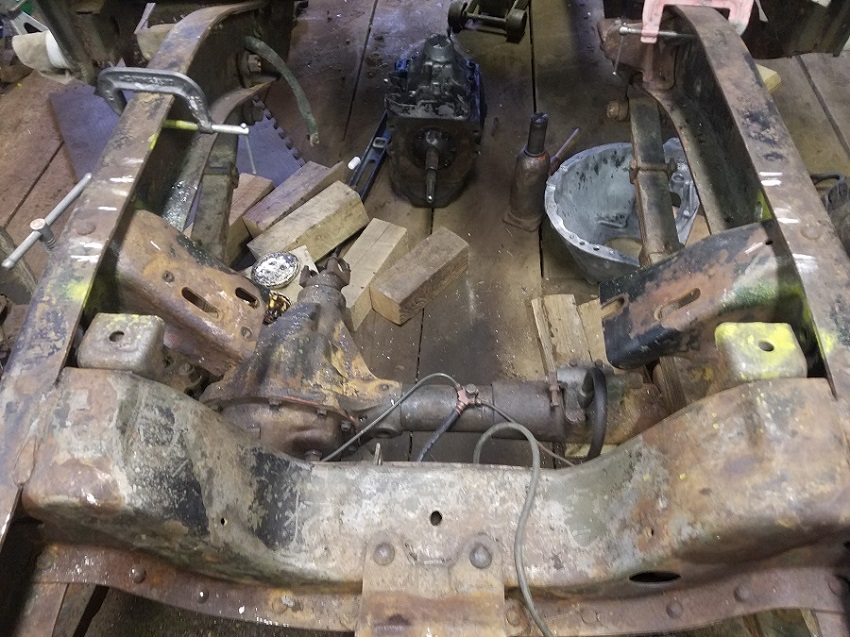

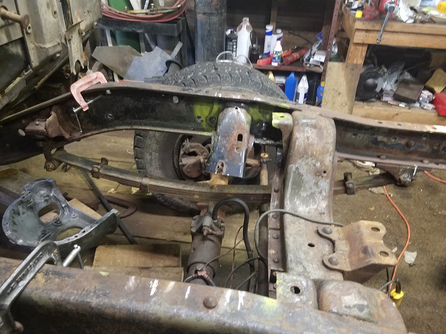

Finally getting back into the M37. So far I've swapped the axles over to D60 and D44 out of a 3/4 ton dodge. Engine will be 360 with a NP435 and stock transfer case. Have it down to almost bare frame to powerwash and blast. Still need to figure out the steering.

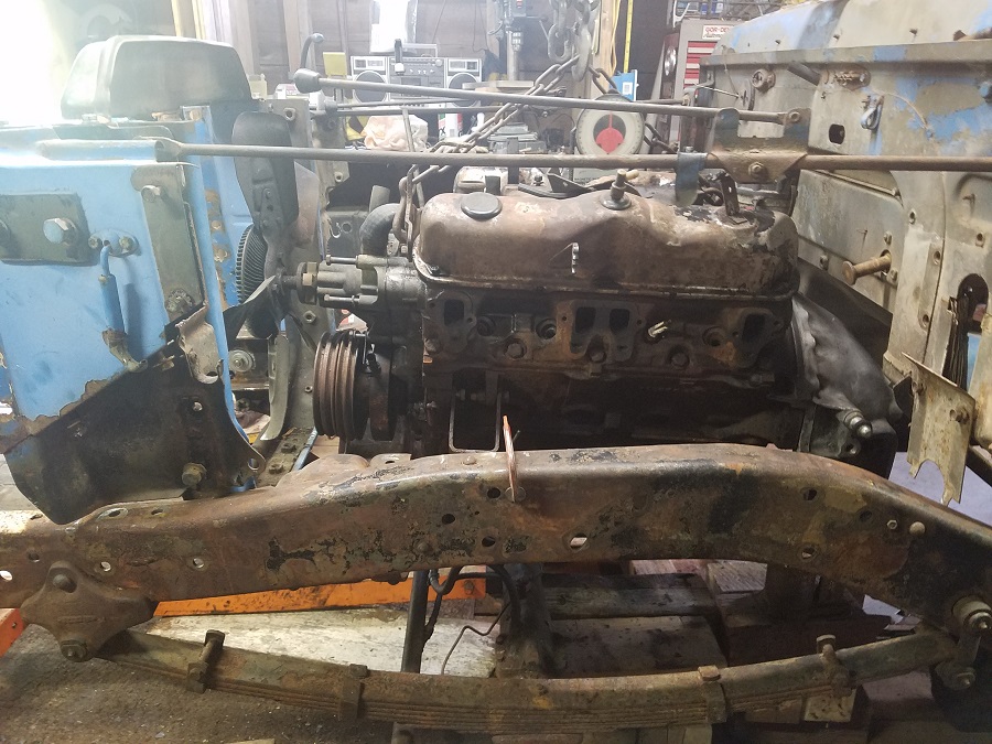

Got the engine mounts located. Need to do some trimming then drill and bolt. Using mounts from donor truck. This seems cheaper and easier than the adapter mounts that are out there using stock location. Will need to build a trans mount but will not need to find the special bellhousing with mounting ears.

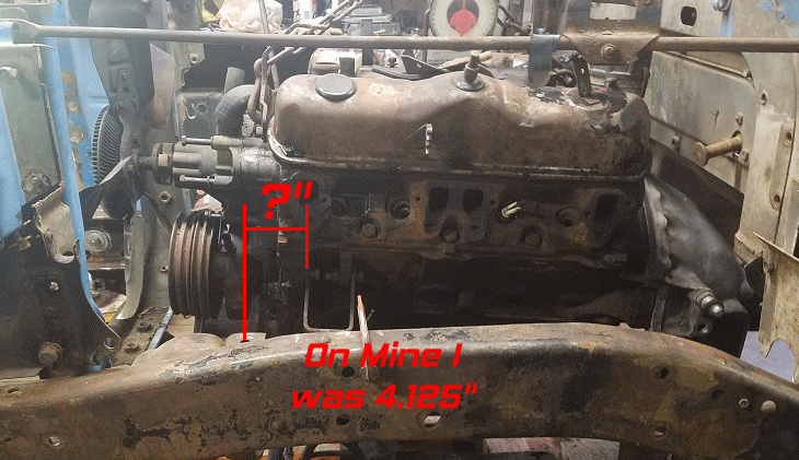

Nice work. I know based on your other post you expect the custom radiator to be setting against the grill, but curious what yout engine mounting locations is based on the attached photo? My '68 short snout water pump V-8 is mounted likly further rearward as I was able to only move the radiator core not the upper tank to clear the front of the engine.

Location is based solely on not moving the trans case. This location allows normal truck bellhousing, NP435, stock intermediate shaft and transfer case location. Was considering moving the transfer case but that is more involved than I originally thought...all the brackets are riveted. Plus with the axle swap I "think" I can use the stck rear driveshaft with no mods.
I was thinking of sliding the engine back till running into distributor clearance issues but still don't know If I could have kept the stock radiator and fan. Was thinking electric fan but decided against. There is quite a bit of room between the grill and original radiator mounting position, I'm sure I'll find something to fit. My jeep radiator fits rather nicely but is probably too small. Mopar small blocks used a 22" wide radiator which would fit nicely.
I'll see if I can find pics of my original truck that show the radiator location. My ideas for the truck swirl around in my head, then I get to work and try some options and see what fits best. I'm too frugal to spend much, most of the parts are reused from the donor truck that I bought.
