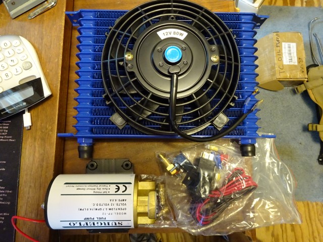

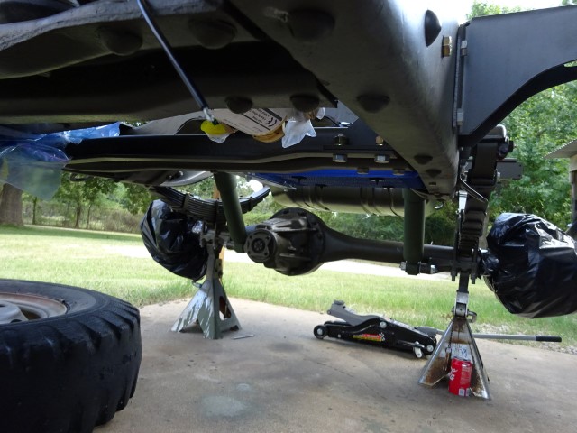

Got most everything to install my TC cooler.

I notice that the fan is 12V. Are you all 12V or will you need a convertor? I ask because these oil coolers are also available in 24V. I think that the M-Series version of this upgrade uses the 24V pump and cooler. WIll be great to see pictures of progress and the final installation.

Jess wrote:I notice that the fan is 12V. Are you all 12V or will you need a convertor? I ask because these oil coolers are also available in 24V. I think that the M-Series version of this upgrade uses the 24V pump and cooler. WIll be great to see pictures of progress and the final installation.
I have converted to 12V- with a Hemi, that's why I need the cooler!

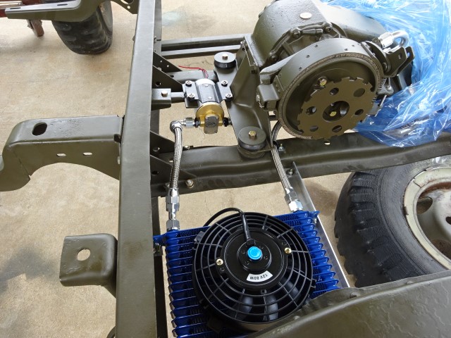

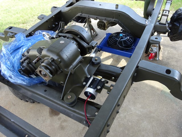

A little farther along...

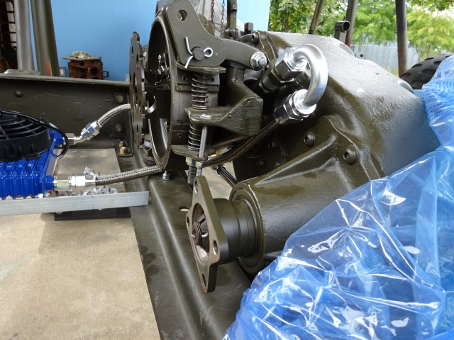

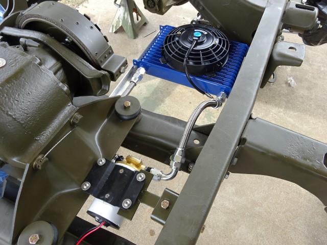

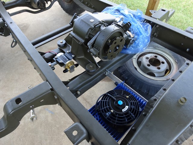

Hoses installed.

Re: Transfer case cooler
Post by Marmalute »
Nice work!
I'm curious, and forgive me if you mentioned this already, but what is the "trigger wheel" looking disc attached to the parking brake output flange?
Doug

Marmalute wrote:Nice work!
Doug
It is the tone ring for the transmission and computer. (5.7 Hemi & NAG-1 5 speed auto)

That is a very "clean" installation. Nicely done.

Nice, but what's the coating on the Cooler?

Post by m-37Bruce »
I did not think about the coating, it is out and down there, good question Will.

Post by rickf »
Yes, the blue coating will reduce the cooling capacity. Flat black is the best color for heat transfer.

Post by Marmalute »
Hey all, actually the color something is has nothing to do with heat transfer ( conduction). Sure, if the source of heat is sunlight it will make a difference, but that should have no effect on this cooler as it is not in direct sunlight!

Post by 06boblee »
The cooler came this color- a chemically resistant powder coat. It is tucked inside the frame area (in the shade). The fan will provide the airflow for cooling- thought about painting it OD but decided not to because of heat transfer issues with even more paint. The transfer case will be cooler with this setup. The fan and pump are thermostatically controlled.

Post by superbee70 »
Color definitely has input on heat transfer, especially radiant. How important it is for a cooler is another matter which is probably designed mostly for other forms of heat transfer.
