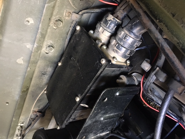

I've been tied up with work travel, but finally back home and had a chance to take a picture of the regulator. It's made out of plastic, which makes me think it is newer. Any thoughts on what type it is?

i've never seen a plastic one, but i've never seen a 100amp system in person either. it's smaller than the big original ones so that's a good sign that it's a solid state system. it might be worth just checking the connections and making sure that there isn't a bit of corrosion going on, the solid state regulators don't usually go bad. at least not part way...it's usually all or nothing when they go

I have the 100 amp system in my 51. It has the same regulator as yours, which is a solid state. The 1/8" plug above and between the two harness plugs is an access port for charging adjustment. Spec calls for it to be adjusted to approx. 27.5 volts. Carefully turn the adjustment with a small screw driver after removing the plug. Measure it at the batteries with a volt meter, as you make adjustments. Since the 100 amp system uses an alternator, the fields are rotating, and use slip rings for the brushes. There should be virtually no internal sparking from normal charging operation. Mine is somewhat noisy when charging low batteries, but it gets less as the batteries top off.
