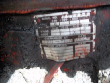

I do have a question on a plate I found on the right side of the engine block, it is located under the exhaust manifold on the back end of the block and about four inches square.
If you can't make out the stamping they are, at the top the numbers - 216784 , then diagonally from upper left to lower right three x's , below the lowest x the numbers 11 space 70 . Does anyone know what this is?

It is a rebuild tag. If the printing was still intact, the "X"'s would be in boxes indicating overbore, rod journal diameter and main journal diameter. Also date or work order numbers. Mine was from Japan Material Command. Rebuilt Tokyo with .010 bore and .020/020 journals. Done in 1956.

Looks like:
Standard bore
Main bearings -10
Rod bearings -20
At least the last time plate was stamped

I might have a picture of my rebuild tag that I can post, to give you an idea of how they looked when attached. I'll take a look and try to post it this afternoon.

A bit blurry but somewhat readable.
Engine rebuild tag 1969.JPG (17.13 KiB) Viewed 13586 times
