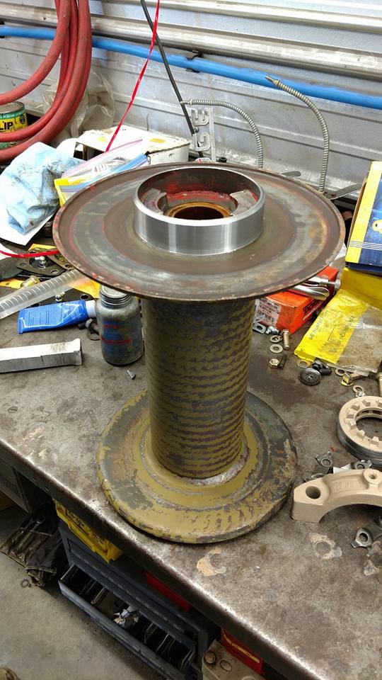

Here's mseries rebuild solution to the problem, a stainless steel sleeve. maybe Charles can elaborate:

Tuko wrote:Here's mseries rebuild solution to the problem, a stainless steel sleeve. maybe Charles can elaborate:
Tuko, thanks for posting that photo. I'm guessing that they had the drum seal surface turned down to the size for the next smallest Redi-Sleeve (99439), and then used a slightly undersized seal with the same OD to fit the clutch housing counterbore (such as a National 417295).
No we did not use a redi-sleeve or undersized seal, as this is one of those cases where no redi-sleeve in manufactured within the realm of correct specs. This picture, which was taken from the M Series Facebook page shows the end result of what we do to repair this, it is definitely a permanent repair. We chuck up the drum in a lathe, turn the minimum material required from the flange to get back round with a good finish, usually doesn't take much. We turn a stainless sleeve from bar stock, press it onto the newly finished flange surface, then finish the sleeve OD to original specs. We replace the original leather seal with a current production Buna-N seal. The final step to getting a leak free installation is very important. Perfect alignment of the worm housing in relation to the clutch housing is imperative, if it isn't perfect, the drum does not run on a true center in relation to the seals on either end, out of center here will let oil leak no matter what you do in relation to seals or sleeves.
