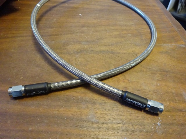

After looking around and listening to all of you,, I am going to use the Fedhill nicop tubing. I will armor it up . This stuff seems to be the way to go, supposed to be very easy to work with. I'll let you know. I am using Inline tubes SS flexible hose.
- DSC00791 (Small).JPG (118.51 KiB) Viewed 4051 times
