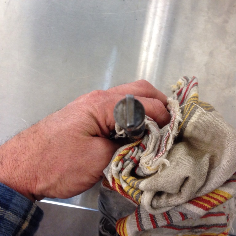

Posted: Wed Nov 30, 2016 3:24 pm
by ashyers
Here's the shaft. Looks like you have a civilian pump. I'll post a pump once I get my phone to send the darn photo!

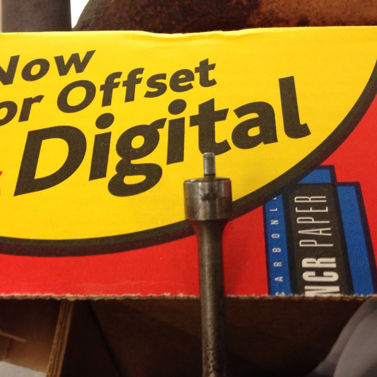

Re: Distributor wobbling?
Posted: Wed Nov 30, 2016 3:27 pm
by ashyers
Here's another shot.
Posted: Wed Nov 30, 2016 3:40 pm
by choppa
So the offset is in the direction parallel to the tang, or in the case of the pump, the slot? See I was looking at it from a concentric perspective. Dang. Looks like I got other issues if the distro wobbles and I got a civy pump now eh?
Posted: Wed Nov 30, 2016 4:06 pm
by j mccormick
That's definitely a civilian pump, the offset is very obvious in the M37 military pump.
