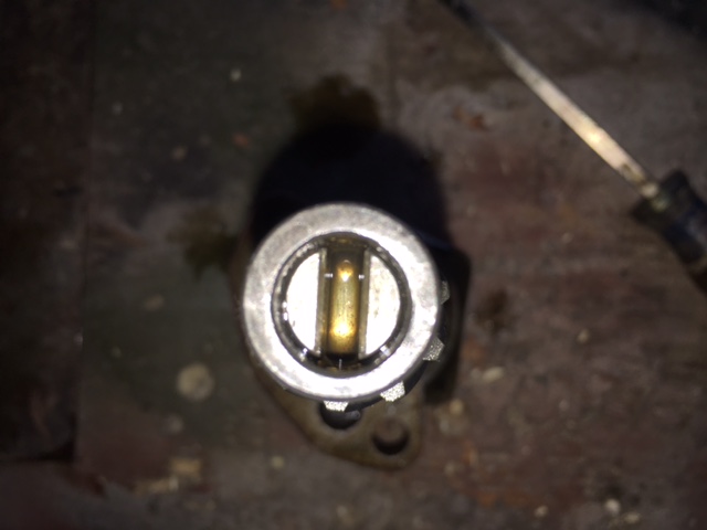

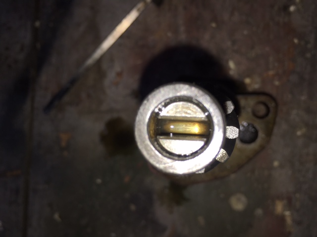

today I decided to take the guess work out, as JUST ME noted, to take a look. To me, upon close looking, it does appear to be "offset" by a slight amount. Non-concentric is best to describe the "offset" looking at it. See attached.
at first I am thinking, this is ALL the offset everyone mentions? if so, its so very slight I can see someone ordering the wrong oil pump in a build up and with a little resistance I suppose a civy pump would indeed line up.
so, is this the "offset" I am looking for, this small amount? it would definatly make the distro wobble even with this small offset.
this look like an OFFSET oil pump to yall? its tough getting a good close up shot with mt cameras phone

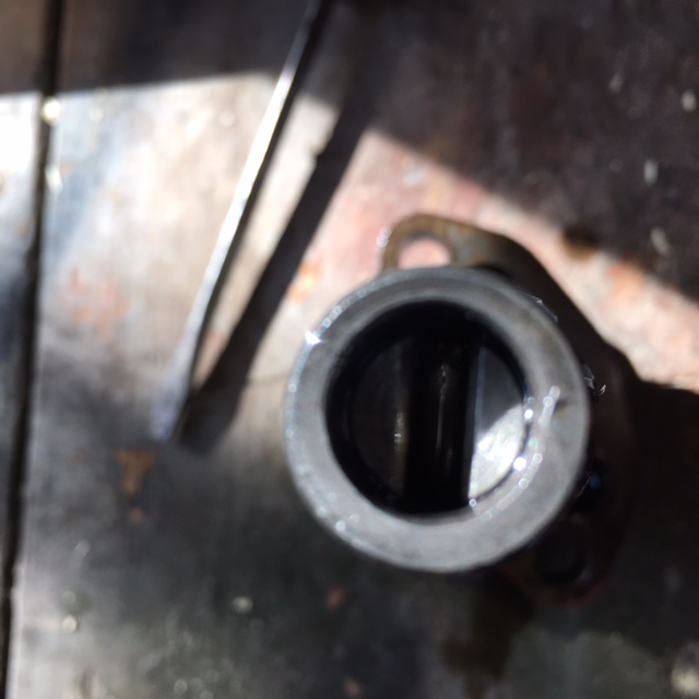

Get a photo with the slot vertical, so the shadow isn't affecting it as much, it will be easier to see that way

Ok i ried a number of photos.. hard to do!
took the best I could of the pump end to show.
its a subtle difference for sure,with the counter bore and slot maybe 1/32" inch non concentric to the shaft or so?

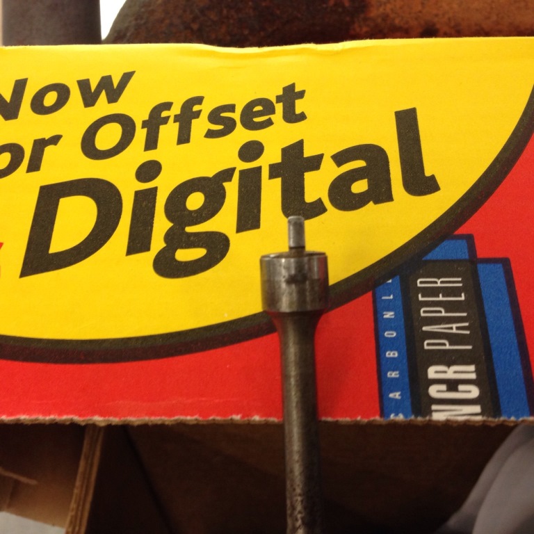

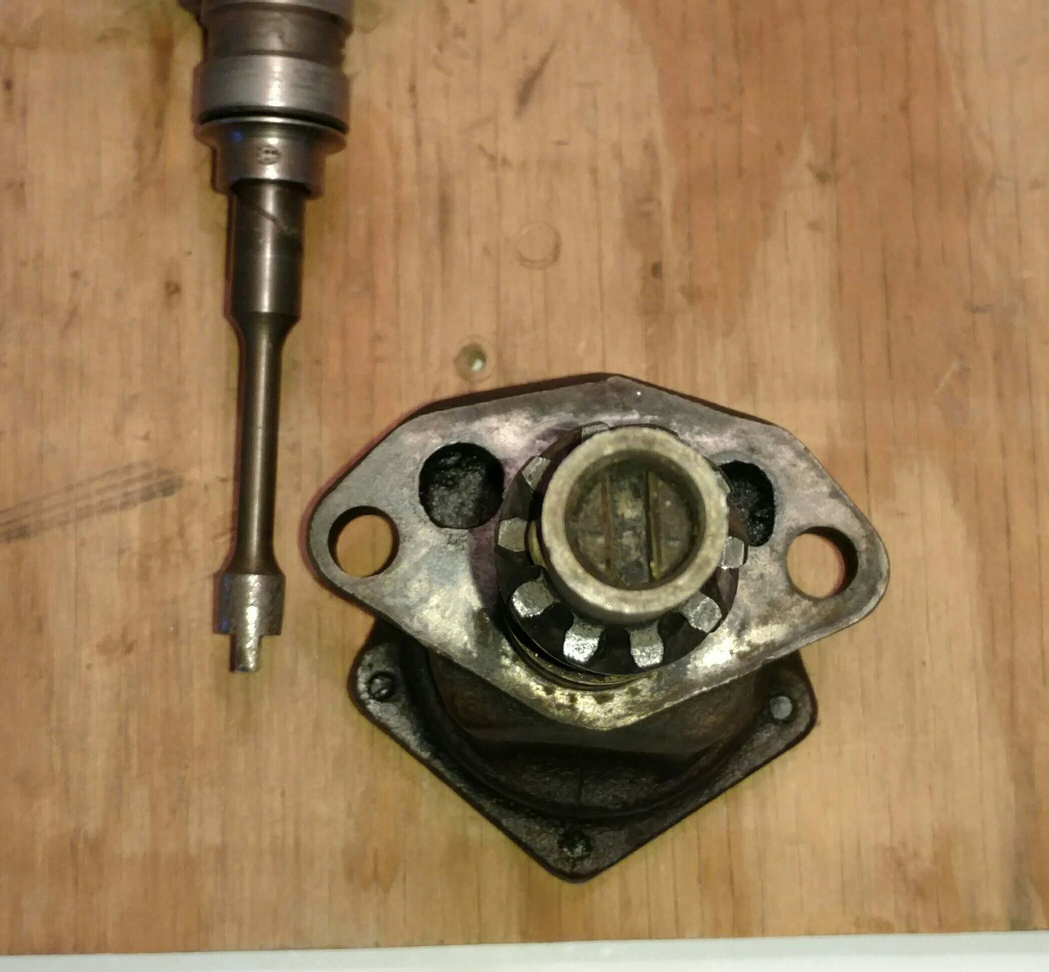

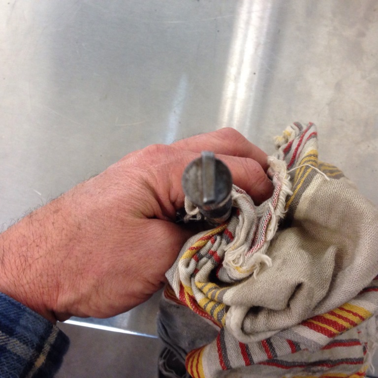

Anyone have an uninstalled M37 oil pump to post a pic of for me to compare mine too ? Like I said the difference is pretty subtle for sure that's what makes this difficult I guess
Re: Distributor wobbling?
I have a civilian in the pile at home. I'll look at it tonight.

Here's another shot.
So the offset is in the direction parallel to the tang, or in the case of the pump, the slot? See I was looking at it from a concentric perspective. Dang. Looks like I got other issues if the distro wobbles and I got a civy pump now eh?

Civilian pump and dist.
- IMG_20161130_170502.jpg (216.54 KiB) Viewed 2807 times
- CPL
- Posts: 116
- Joined: Wed Aug 04, 2010 2:47 pm
That's definitely a civilian pump, the offset is very obvious in the M37 military pump.
