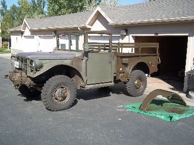

Okay so I got a little time in the garage and I was able to do a few things.
First I didn't like the steering column that I made as I couldn't get it to stay secure and well I didn't want to be driving down the road and have the column come apart on me. So I decided to use a M151A2 steering column. Was able to get an NOS one off fleapay and the great thing is the spline on the steering wheel is the same as the HMMWV so I'm able to use the HummVee steering wheel. Had to change the connector to a 3/4 round from a 3/4 Double D, but other than that it went right in.
I can't find my steering column clamp from the truck...it's someplace and I'll find it when I clean up here so for now I threw a u-bolt in there.
The other thing I wanted to work on was the headlight bucket. Since this is truck is suppose to be a B3 version I figured the Army would upgrade the headlight buckets to the system that has been mill standard for the last 50 years. I used headlight assemblies from a HMMWV and inside the bucket made some L brackets for the supports to screw into. This will allow me to assemble and disassemble the headlights, hook up wiring etc. I think they came out good.
Here is the old front.
New Front
Old from the side
And New side
It felt good to get into the garage again.

I LIKE the headlights! That is slick!
