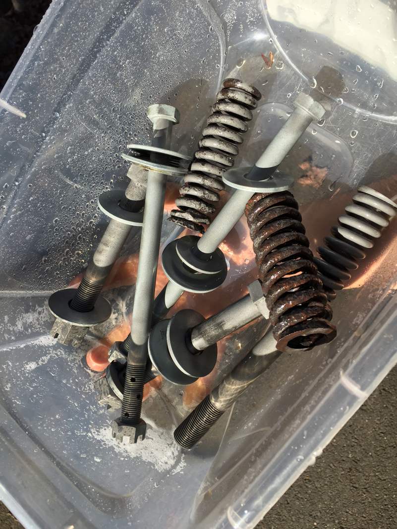

Does anyone know where I can buy these bolts with springs in them? They were for securing the cab to the frame.

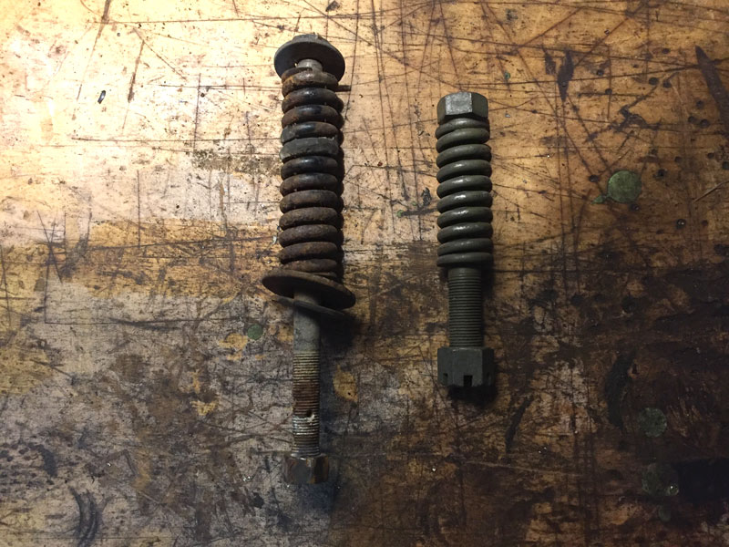

Here I have a long and a short one. It's hard to tell but I think the long one goes on the rear and the short one on the front, one on each side? Is that right?
Vintage says they don't sell anything like it and I should just use a plain bolt. I'm calling BS. Thoughts?

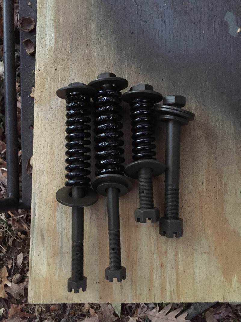

The bolts were all around rough with the heads practically pitted down to nothing. Since I was in there I wanted to make them look somewhat uniform. First I tried Home Depot which was a waste of time, then I went to a local fastener supply place. Of course they had what I needed.
2x 8"x1/2" bolts with crown nuts
2x 5"x5/8" bolts with crown nuts
2" and 1.5" washers
Springs as needed
Cotter pins as needed
I was able to reuse the springs I had. They were a bit pitted but still serviceable.
I haven't installed them yet so I can't confirm that it's going to work, but they look identical to what I took off so I don't see why it won't. I'll take a pic of it once they are in.

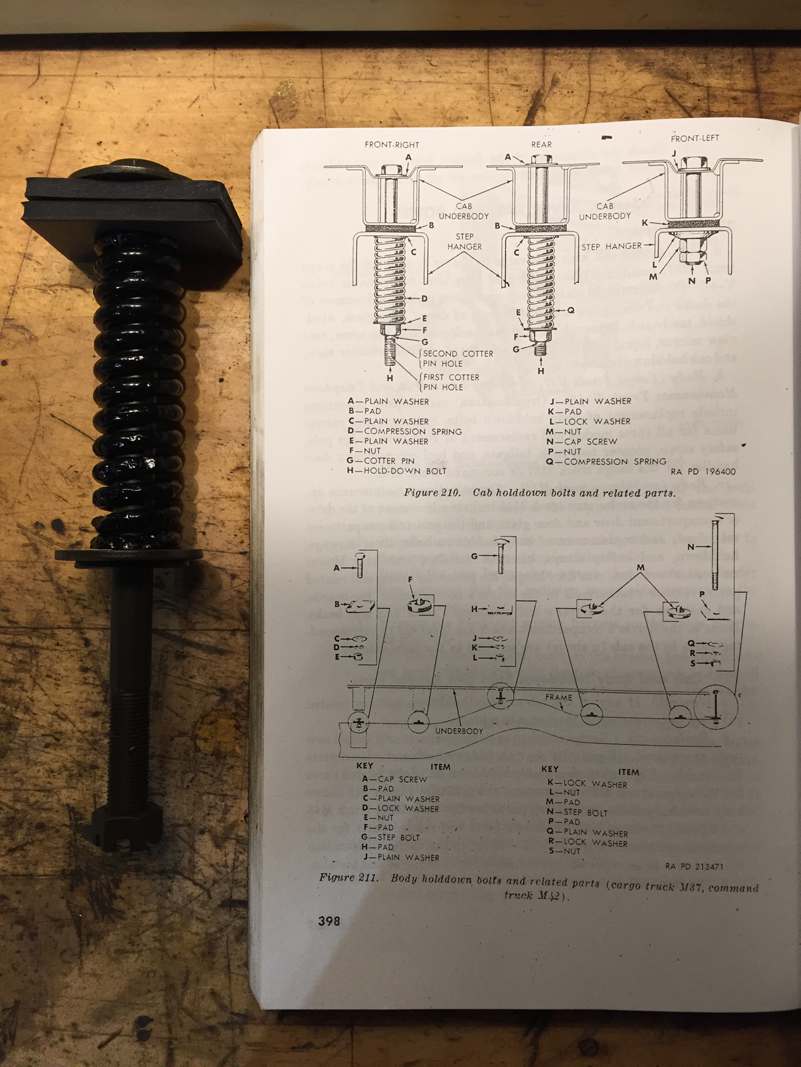

OK so after looking in the manual I found this nifty little diagram. I forgot that when I talked to Vintage about the bolts which they didn't sell, they did recommend these rubber pads (where it says B-Pad). The manual calls for one on each, but they said best to double up. Figured what the heck can't hurt anything. I did have to widen the hole a bit for the bolts to fit through.
So far I've got three of the four installed. They went in pretty easy. I should get the last one done tomorrow. Hope this helps someone down the road!

nice diagram thanks. answers my questions. I have a hunk of conveyor belt I cut stuff like that out of. really tough stuff.

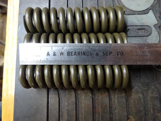

Hmmm...I was checking the cab mounting bolts and three springs in my pile of parts that used to be an M37, and noticed that I have a similar arrangement of two springs that match the description in the ORD 9 SNL parts book, and which were on the rear mounts if my memory is correct. But the third spring is larger in diameter (1.290") and slightly shorter(3-5/8" uncompressed). Not sure about the bolts, as I had to destroy two of them to remove the cab, but the two remaining ones are long and match the dimensions from the parts book.
Except the the book (section 1801) shows that all three of the springs and associated bolts should be the same. And yet, fig. 211 in TM 9-8030 (the one that jrodjared posted a photo of) seems to show different size springs between the rears and the right front mounts. So which one is correct?

All 3 of mine are the same size, '54.
Posts: 952
Re: Cab Spring Bolts
Thanks for posting that photo. Those springs look new!
