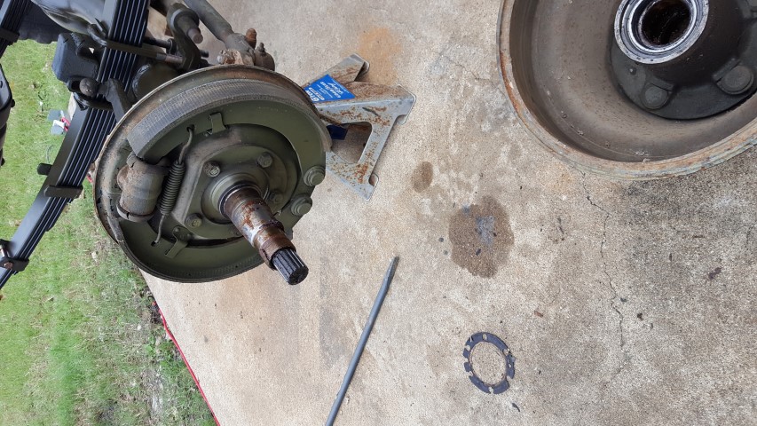

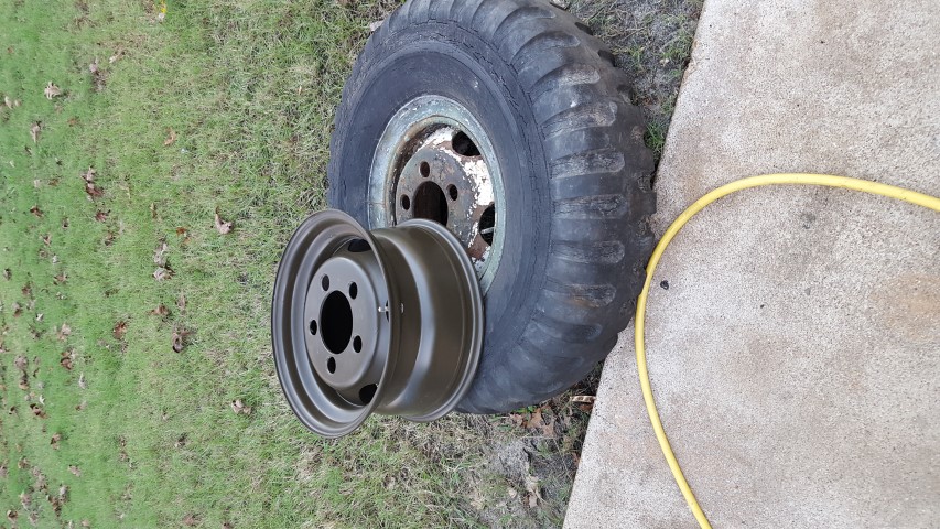

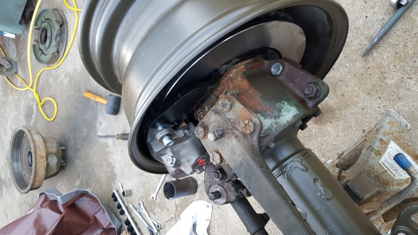

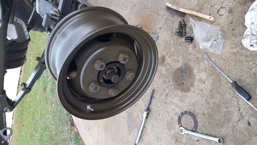

I had these wheels made a few years ago using the M37 center. I have a Helitool disc brake kit. I had to see if the wheels would clear the caliper. Here are some pics.
20161109_164045 (Small).jpg (192.82 KiB) Viewed 3957 times
20161109_161215 (Small).jpg (205.44 KiB) Viewed 3957 times
Re: Disc brakes and tubeless wheel

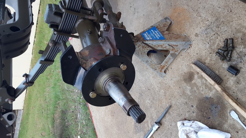

more pics
20161109_170108 (Small).jpg (168.1 KiB) Viewed 3955 times
20161109_170058 (Small).jpg (186.53 KiB) Viewed 3955 times
20161109_165646 (Small).jpg (214.21 KiB) Viewed 3955 times

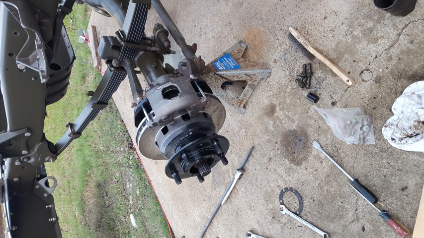

A pic
20161109_170306 (Small).jpg (221.98 KiB) Viewed 3955 times

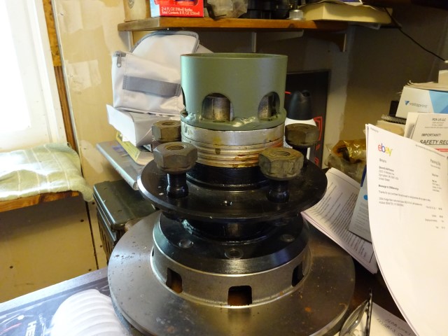

one more. Oh the wheel fit great.
DSC00335 (Small).JPG (111.43 KiB) Viewed 3955 times

Nice! What is the Wheel Size and backspacing?

It is 16"X8" , the backspace 7.5"

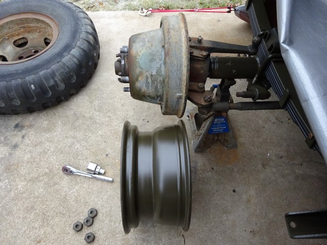

Actually if you choose to go with 20" rims, the selection of tires is much greater. I will try to put one of the wheels on a drum and see how it fits (16").
squeeky0_50 wrote:Did you ever try the stockton wheel to see if it would fit over the stock brake drum?
Sorry, forgot I was supposed to do that. Tried it this morning and it fits fine.
DSC00743 (Small).JPG (130.4 KiB) Viewed 3666 times
