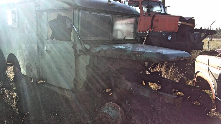

I was going to say "I am seriously considering buying an M43 I found with no power train or rims." if I can find rims for it, but I'm sure I'm going to do it anyway. :D
That said, does anyone know if there's a source for them in the Pacific Northwest?
It's fairly complete otherwise and seems to only have had a few modifications. Gages, sheetmetal, axles, interior - it's all there, and the scrapyard owner is a Mopar fan. He's willing and eager to trade it for a 1974 Dart Sport / 71 Demon clone project car that hasn't seen a wrench in fifteen years.
I don't know how I'll power it yet. I'm open to suggestions..
I'm new to the M43s, but not vintage vehicles. I've got a 1948 Willys CJ2A and a 1954 GMC PD4104 Greyhound bus.
I'll post pictures as soon as I can.

I'm thinking 'Original within reason'
It turns out that it still has the transfer case.
Whether I go back to the original power plant will depend a lot on what it would cost, and parts availability. Generally speaking, I'm not a fan of the 'stuff a V8 in it' thing. I won't repower with anything that would involve cutting original metal.
I repowered my 48 CJ2A with an odd-fire Buick V6 without any cutting/welding the frame & tub except for a notch to the right of the transfer case shifters. This was in sheet metal I had to replace anyway. I did cut & weld a spare trans cross member. Doing it this way means going back to the stock motor is a bolt job with all stock parts, and doesn't ruin the value of the vehicle if it gets restored in the future.
I'd do the M43 the same way. I would look at a number of options:
1. a period-correct repower. What was a popular motor to replace the flat six with? The only V8s I would look to would be the flatheads.
2. power plant from a newer Power Wagon. I haven't looked at this, so I don't know if it would be feasible.
3. military repower. Was/is there a 24v military motor that would be appropriate?
4. small mechanical diesel
I'd prefer something that sounds similar to the original motor, or is distinct in it's own right. I don't want a small block Chevy/Ford/whatever. The yard that I'm buying it from has a couple Mercedes cars with the OM617 diesel (with and without a turbo), and there are adapters to mate it up to various Ford, Chevy, Mopar, and Toyota transmissions. Having a divorced transfer case opens a huge realm of possibilities. The question would be 'will it fit without destroying the historic value of the vehicle?'. I'd like it to be usable/drivable and have the option to install a correct engine and trans that have been freshly built down the road.

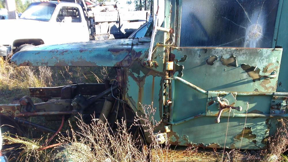

As far as the interior goes, it turns out that my cursory look in the cab missed that the original gauges are gone, as are some of the various switches. It does have the spotlight and a 24v generator.
So I'll figure out something with the cab and slowly work it back to original as I can find and afford parts.
I'm going to go with original paint, lights, wheels, but probably not the tires. I know lots of people love the NDTs, but they were designed as an artillery trailer tire, not a traction tire. I'd likely use Super Traxxions or a modern M/T that's not outrageously out of place. Something like the Cooper Discoverer STT in a size as close to the original as possible.

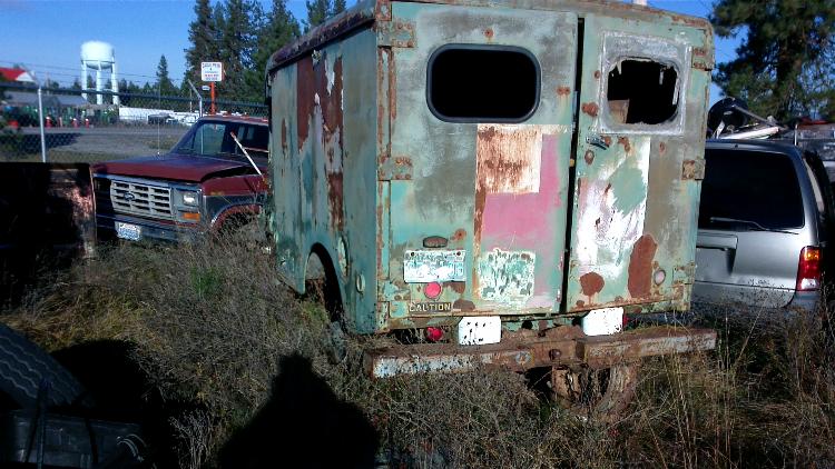

I'll keep the box interior as stock as possible, but likely fill the storage with camping / hunting gear. :wink: She won't be a show truck. She'll get driven and used, but able to stand in properly and respectfully at a Veteran's Day parade.
OK. Let me see if I can get some pictures attached...
The US Army markings are present on the hood. I'm hoping I can peel enough paint from them to figure out where she came from.

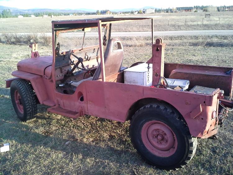

This is my Willys, shortly after I bought it two and a half years ago with a broken frame, no brakes, and numerous other problems:

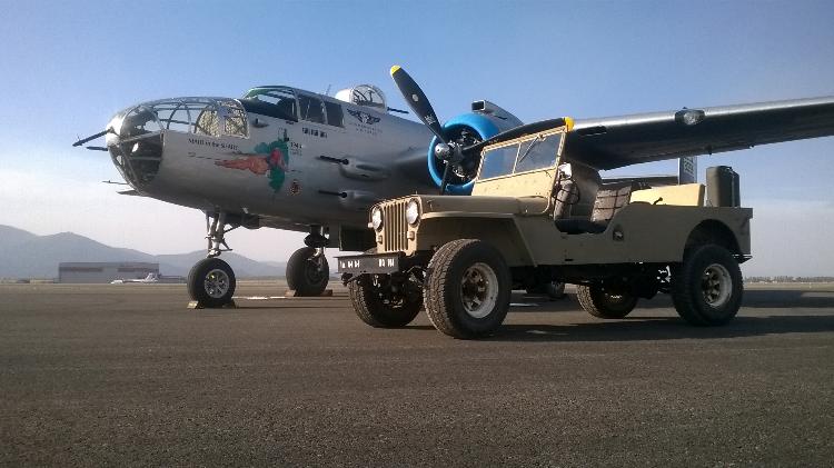

This pic is from late August this year, after untold hours of work - you know the kind I mean:
My wife supported me 100 percent getting Ironsides to the local airfield to get this picture. I buttoned up a transfer case rebuild, tranny work, and a Buick 231 Odd-fire repower to make the deadline for this photo shoot. We made it by less than two minutes.
I promise this level of dedication to my M43.
