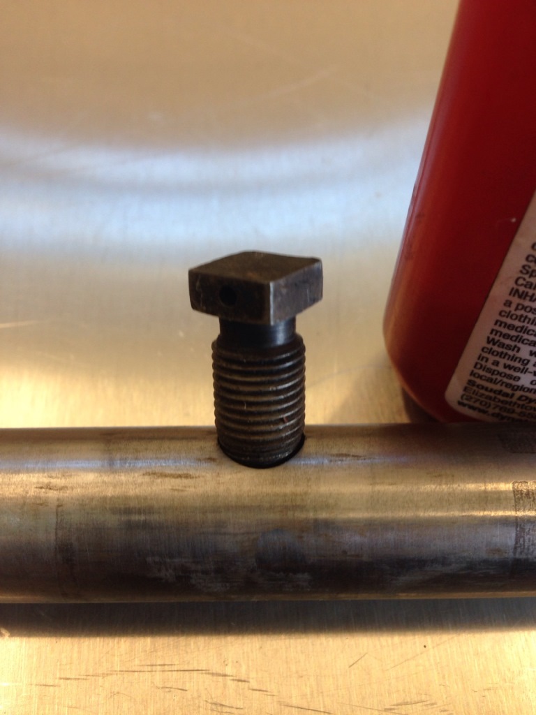

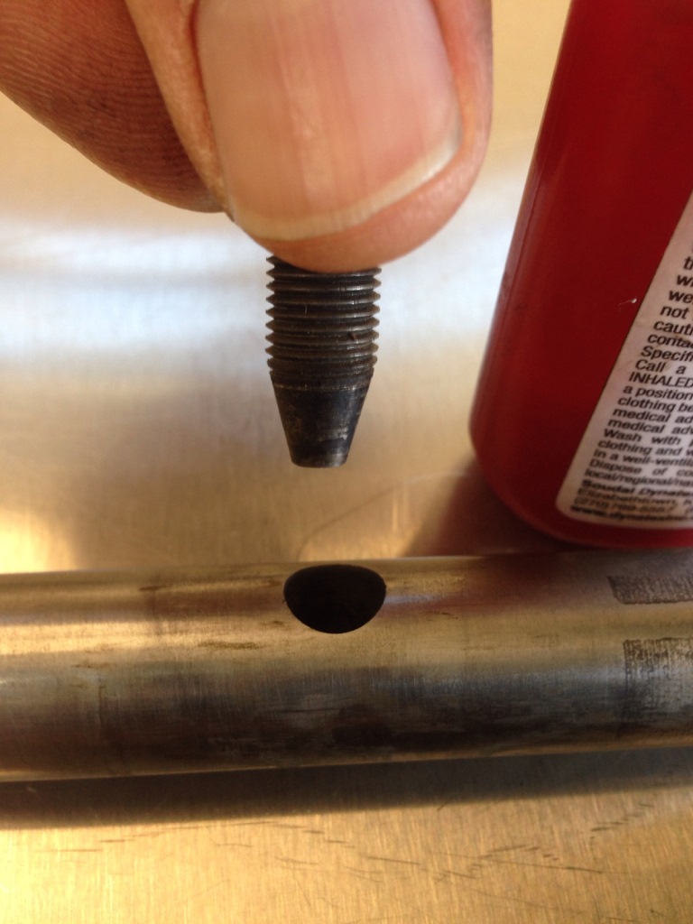

So the shift rail and set screw.... are they anything special? I was thinking just a flat set screw but guess it could be a conical point that mates into the shaft??? Anyone help with pictures of these parts? And if they are something special, where to get them?

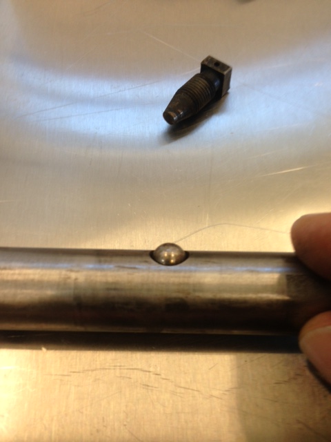

This may be of use when you're trying to figure out how much bubble gum you'll need to use to stick to that sucker. Good luck!

Dang, why such a perfect fit!!!??? That picture is exactly what I'm dealing with. I tried and tried to get it out without removing the T-case. I've given up and started to remove it. Got everything loose but one mount bolt that's stuck. That's when I dropped the wrench and gave myself a fat lip....... So gave up for the evening. Gonna try to get back to it one evening this week.
My next plan is to get it on the bench and try to blow it out with air, or literally go the bubble gum on a stick route! (maybe a little better than bubble gum but same idea!)

I just used Loctite. Don't know if I will regret that, but the only screw I could find was an Allen head. And didn't have a hole drilled for wire, and I didn't attempt to drill one as it was a pretty hard metal.
I did toss the set screw on my lathe and turned the tapered end so it fit nice.
I'm banking on the modern Loctite will be just as good as tie wire. At least for the limited miles this thing will probably see. And I made sure to get it good and snug.

I'd get the right screw and use that tie wire, McMaster - Carr has them, or they used too. My reason, I've seen gear teeth eaten by a set screw floating around, it isn't pretty but will take a PRETTY penny's worth of parts to repair the end result.
