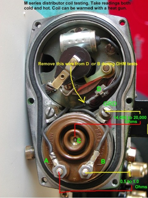

Carter, In that picture, shouldn't there be a reading from terminal A to B?

A > B reads 0.5 to 1.0 Ohms according to the photo, lower right corner.

Carter, great pic........thanks! For coils that are out of the distributor the way I remember how to check resistance is;
Primary: "Positive (+) Terminal" to "Negative (-) Terminal"
Secondary: "Center Tower" to "Negative (-) Terminal
To muddy the waters a bit........you can also check the secondary resistance by measuring from the Center Tower to the Positive (+) Terminal. Done this way you're adding in the resistance of the primary coil, but it's so low compared to the Secondary resistance that it doesn't affect the reading. You might also want to turn the coil upside down while you're checking it to make sure it's still sealed. If oil leaks out the center tower it's junk, no matter what the resistance is.

Are you guys sure about those primary ohm readings? I read a lot of searches about it on this site and I never saw .5 to 1 ohm for a primary resistance. More like 6 to 12 ohms. I was reading them like the downloaded picture showed, but out of the distributor. I think I will order a couple of new coils, or NOS.

I would have to go through my old notes to verify those readings and as stated I copied the pic from what Sal posted.ZGjethro wrote:Are you guys sure about those primary ohm readings? I read a lot of searches about it on this site and I never saw .5 to 1 ohm for a primary resistance. More like 6 to 12 ohms.
After checking I located this, more believable I am sure:
On the primary side you should have 6 Ohms, on the secondary side you should have 14.5--15k Ohms.

Thanks Carter. I didn't think 1 ohm seemed right. neither of the two coils I have fall in the desired range, so I think I will order new ones.

Hi Guys,
I did a little searching around on the web and it seems no one really knows what the primary resistance for the 24V coil is supposed to be. My notes say 6 ohm, but I don't know where I got that from, so it's suspect. The 0.5 to 2 ohm numbers seems to be standard for 12V automotive coils, so doubling or tripling that number for a 24V system would make sense to keep the current low in the primary. But like I said..........I haven't seen it printed anywhere yet.
As for coils, I believe the first repop coils were made in Turkey......and weren't too reliable. The newer ones I think come from our friends in China.......and haven't been that well received. I don't know if the primary resistance of the NOS coils, those made in Turkey, and those made in China all have the same primary resistance. If anyone knows for sure......or knows where in the TMs it calls out the primary and secondary resistance values for the original Auto-Lite coils, please post it. If I get some time later I'll do a bit of digging on my own and see what I come up with. We need to get this sorted once and for all.
