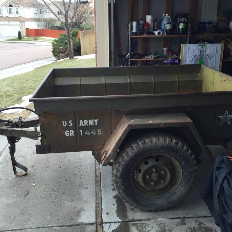

Found a '66 M416 that made it home today . Its light cord was cut. I put an ad in the WTB section

Jay,
That looks to be in good condition. Keep us posted while you restore it.

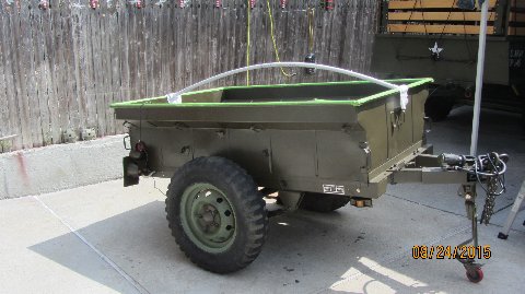

If you buy the canvas cover make a ridge board down middle to shed water off of it. Even if you store it indoors it looks good. P.S. Magazine showed the official MWO for it by using a 2 x 6 and cut a 60 degree on two corners of the board and then notch the opposite corner to fit over the rim of the bed. The board fits the length of the trailer. I've also seen folks cut down duce and a half bows to go over the width of the trailer bed to make bows that way also. I've even seen someone take a set of tonneau cover bows to do the same thing. I loved having the cover when I had a M416.

I did the same thing as K8 described for my trailers but I used a length of 1 inch PVC pipe and 2 tees.
