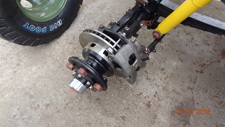

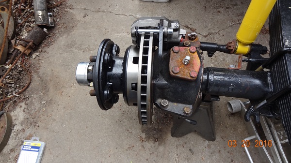

Fixed the problem. I got the 2WD calipers. Sent back for 4X4 calipers. These fit. I got the c and not k GMC calipers. Assumed (there's that word) The 2500 were 4WD. In the 80's they were C/K and could be either or. Now back to progress on project Mohawk.
tomor13
Posts: 64
Joined: Tue Feb 24, 2015 11:50 pm
Re: Helitool front disc brakes
Post by tomor13 »
Front installed rears done for now.

Looking great Tom. Glad you got the right calipers and resolved the issue.

Boy do those look nice!

These brake parts that are pictured here in a prior post fit the flat fender power wagons (WDX, WM300, etc.) some later WC military models, and the military M37 trucks that have the Dodge axles. They are not compatible with the DANA axles that were used on some of the various later models.
