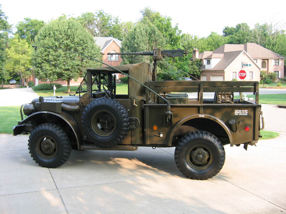

I have been considering removing my cab canvas top and framework but, I've never tried it and was wondering how big a pain it is to remove and reinstall. Thought about going topless for parades. Here is present config.

I go from a full vinyl top with a rear window and no zipper, to a bikini top twice a year. It takes about 10 minutes to remove a top, and about 20 to put one on. Those times are probably a bit long actually. I never remove the framework though
Re: Cab canvas top removal questions.
Easy.
Follow TM9-8030 to remove canvas. (About 5-10 minutes)
Remove 4 bolts at windshield.
loosen top bow clamps
Remove top bow
Loosen u-bolt nuts behind door posts
Lift out the sideframes
Pull bolts out of slots and store all items where they wont get lost.
Reverse to install.
Remove top bow
Reverse to install.

I have to take my bow that goes across off and my top half off just to get mine in and out of the garage. A pain In the ass sometimes but its worth it.

Thanks for all of the replies. I think as soon as the weather warms, the top will come off. Might just try it for a while, doesn't sound too difficult. Not afraid of the work, just don't want to have to have another person helping, most help I get just gets in the way.

It's an easy job-I do mine by myself whenever I need to remove/install.

It is pretty straight forward, I do it at least twice a year. I use a rubber mallet to bang the top bow off as it sticks. But driving with the window down...priceless....Get goggles
