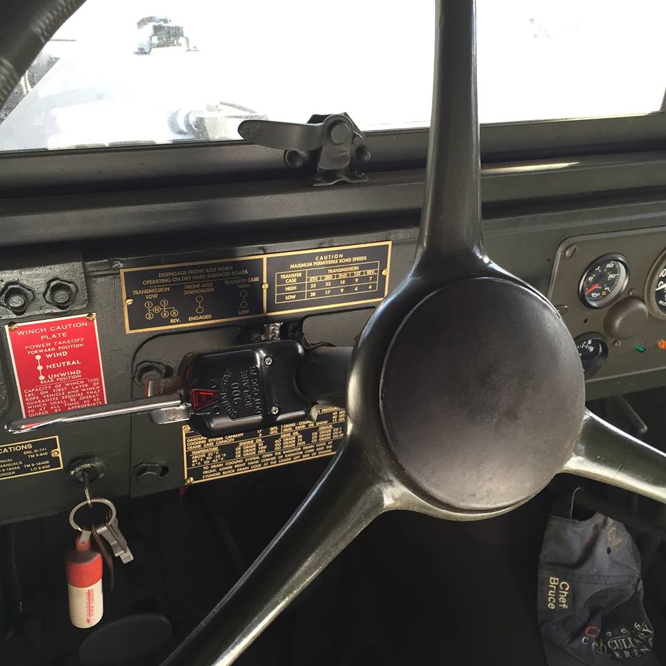

I used the Painless kit and did the turn signal install as well. My fuse box pic was to large to up load?
- My Dash 1.jpg (89.47 KiB) Viewed 4168 times
