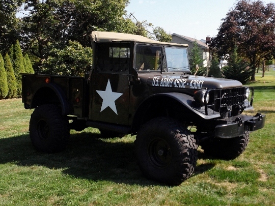

Rig is modified with Chevy 350 engine and Turbo350 3 speed automatic , NP 200 transfer case and 5.83 3rd members . I am using 75 - 90 weight oil in transfer case and diffs , 3rd member looked like it had been rebuilt at some point , Bought it from John at Midwest as a used part , It appeared to be okay and was installed correctly . The noise is only when there is no pressure on the drive train and goes away when pressure is applied . Truck is also lifted and there is 10 inch drop from transfer case to rear axle , I will need to use a double cardan to get the proper pinion angle at transfer yoke . I don't feel any slop at the transfer yoke or the 3rd member so I am not sure what could be causing the grinding noise . Thx Dave

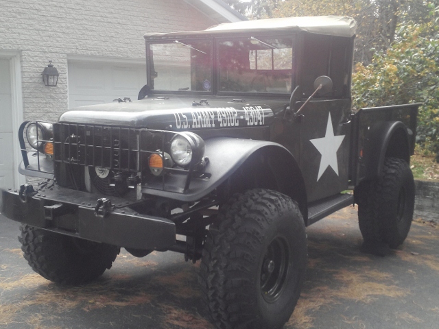

Thx . Plans are in the works to send the 3rd members to Bob Stahl and regear to 4.89 and I will change out gear oil to a lighter weight oil in transfer case , I hoping the noise is in the 3rd member as I was already planning to get them redone .
