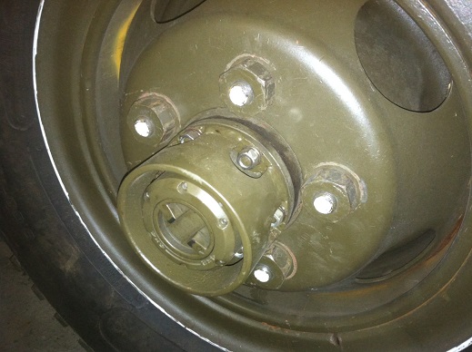

Selectros probably offer the shortest profile; I run Superwinch hubs on mine and they stick out quite a bit. I recall that Bryan Sage used to make guards for the Superwinch hubs-unsure if any are available anywhere.

I was thinking along the same lines as you........I wanted to find a pair of hubs that weren't noticeable...........but they don't exist. I've taken pics of the different hubs installed on M37s at meets I've gone to over the past few years to compare and none of them are "thin".......they all stick out about the same, give or take. I plan on getting a set of Selectros and milling off the logo and "heavy duty" lettering and painting them OD with the rim. I've seen the hub guards that Bryan made.......they just make the hubs that much more noticeable.........but are a good thing if you do a lot of rock crawling.

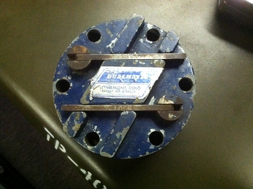

I have a set of Superwinch hubs with hub guards on my m37, they stick out 3 1/16" with the guards on. The hub guard adds about 1/8". I also have a set of the Dualmatic lever type hubs and they measure 2 5/16". I have a Selectro style hub around here somewhere but I think the lever type Dualmatics are probably the shortest.

I have a NOS set of Warn hubs installed, I would say if you get the reproductions of this hub, they may cover the bases as far as what you are looking for. Nice and tight profile.

Those Dualmatics are pretty pricey , I found a set on ebay.

yeah the set i see is green, used, and they want $500 for them. they do look pretty bomb-proof though

Id like a set of dualmatics , just to cut the profile down. Ill never use them , I only drive on road but don't want them to be very noticeable.
