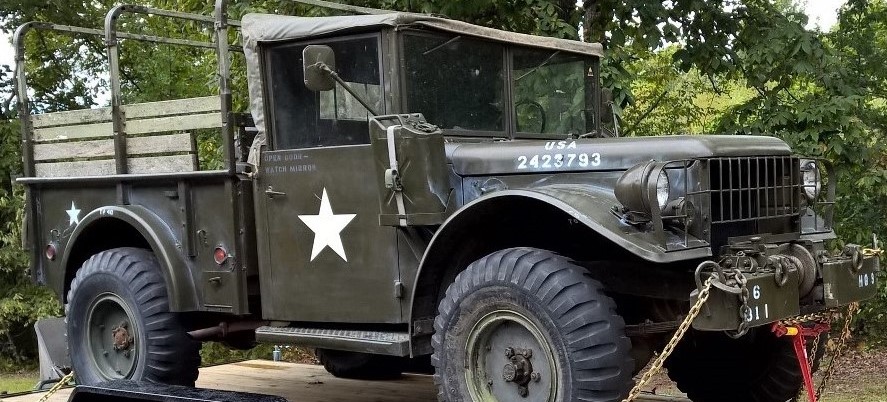

Just picked up truck # 972 on the register, a '52 35424 serial numbered basically unmodified truck with 19k miles on the speedometer.
Some questions that right away have come up are;
The steering is atrocious! It has 11.00x18 NDCC tires on it now ... is that a negative impact on steering ease/lack of same?

M37s are different than your typical 4x4. I used to fight with mine 'till I gave in and let it determine how it was to be used. Put back to "stock" and driven like they figured they'd be back in the 50s, they actually work really well. For normal street driving I hardly notice 1st & 2nd don't have syncros. Its always 3rd, 4th, 3rd, 4th.. Shift to 2nd after stopping. After awhile you get used to a top speed of 47mph. In fact, it kind of relaxing.

Good luck with it, it looks really nice in the photo.

For tires and steering it looks like your M37 a custom rim and tire size on it. Tires could be from a M561 Gama Goat, but I could be wrong. I would change back to the 900 x 16 stock rimes and tires if you want to keep it looking stock. The bigger tires was probably an attempt to get a little more road speed. With the stock tires you'll find the steering a little better. It still wont be power steering, but will be manageable. If you want turn with the palm of one hand then you'll have to convert to power steering. Not a simple swap, but as mention before Snake River has all the parts to do it.

The Truck steering is very hard to steer/turn the wheel. One of the first things I'll do is switch the four 18" to four 16" that came with it. The 16's have 10.50x16 LT directional tires [well used old rubber/tires] on now. Then make sure their pressure is up to 'code' and that the linkage is greased. The steering wheel itself is cracked badly on all three spokes so will want to find a NOS replacement soon, if any are out there?

Typically with manual steering the thinner the tires the easier it is to turn them. It's all about contact area with the road and frictional forces. Less of both makes it easier to turn.

Hello Dick. I am running the same Power king Premium Traction tires that were new on the truck when I bought it six years ago. I bought one more for a spare and it cost me $187. They seem to work well, but they don't have the stock appearance

Make sure the 11.00's have proper air pressure.
Stock 9.00's will give only some 5K miles service.
The 11.00's will ride better, last longer.
I've run them for over 20 years.
You will have a bit better road speed.
I'll never put 9.00's on an M37 again.

I do want to either trade them (there are the 4 on the ground, the spare is the stock 9.00x16) or sell them.
