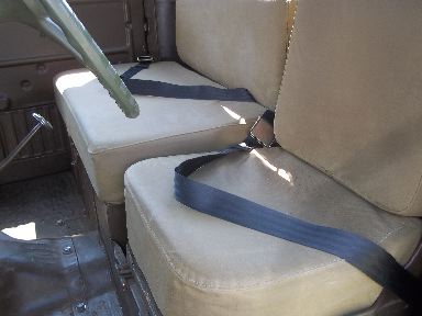

I shared that I'm now running errands rather frequently up and down the 10% grades here in the Wasatch mountains. Seeing the uncertainty and fear in my wife's eyes when we're on those grades resulted in me adding some generic military belts that I got on eBay a few years back. Anyway, I had this post out here but somehow it is gone so I have added it again, with a picture. Seems a lot safer with the lap belt, especially with Winter on the way, and they tuck away out of sight if I display the vehicle.
- seat belts installed.JPG (16.67 KiB) Viewed 3085 times

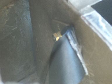

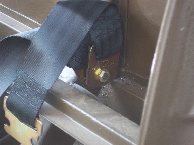

Sorry for not adding the mount process. I used Grade 8 5/16 bolts with star washers, using a step bit on the passenger seat box frame, a shared mount on the center reinforcing brace, and the driver's box frame. The belt brackets have reinforced support rings stamped within so I am confident that they'll do the job (especially at the speeds I drive).
- passenger outer seat belt mount .JPG (11.02 KiB) Viewed 3050 times
- center shared seatbelt mount.JPG (17.09 KiB) Viewed 3050 times
