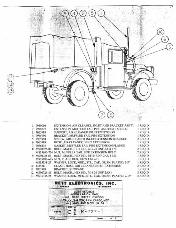

Fording kit pictures
Post by Cav Trooper »
Does anyone have a picture of the exhaust pipe for a fording kit in the stored position on their truck?

Thank you. Do you have any closeups of the what the brackets look like with the pipe attached in the stowed position?

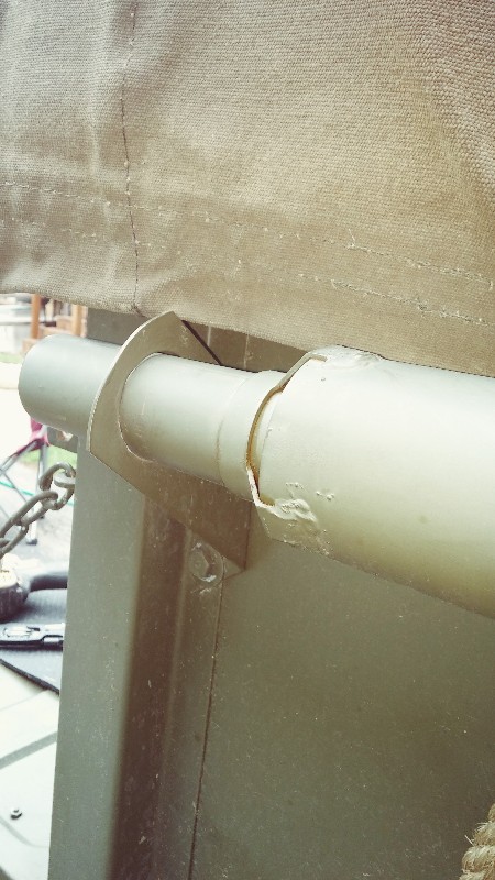

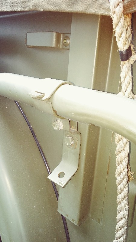

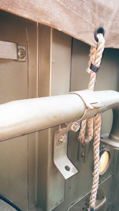

Here are the photos I promised last week.
I said I try to take a few pics and post them if it didn't rain. Well, it didn't rain, but we got an incredible wind storm instead which took down a lot of trees and power lines. No power, no computer, no pictures to post. :oops: :cry:
But we got our power back today, so now I have a computer (I can't post pictures from work), so here are some pictures. They are not very good because I had to take them in the garage instead of outside. but I hope they help.
Not sure if this is the "correct" installation, but it is how I installed it.
I hope those pictures show what people were looking to see.
Sorry for the delay. :wink:

Great, just what I was looking for. Beautiful truck too!
