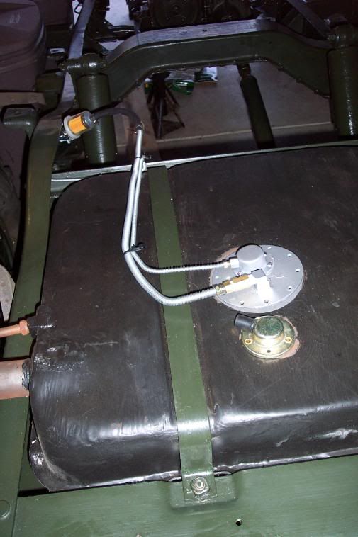

Hey Knattrass, I hate to tell you this, but most of what is the rear of your vehicle is missing ! Just funnin ... So far I re routed my 5/16" line away from the header, and fastened about 20 wooden clothes pins. Looks real profesional; ( e gads ! ) Also John B suggested I tighten the fittings at all points in the line, which I did , save for the tank, as he is sending me a new in-tank filterWell then, and thank you Knattrass for this picture, you know what Confuscious says about pictures : " Get your M37 parts from John B at MWM"

Gentlemen, As I look thru the 50,000 pages of my M37 CD, I do not find the fuel line size dimention/diameter at or near the gas tank. Any input will be apprciated as I am going to go forward with my "inline" electric fuel pump, and spin on filter, and regulator, and pressure guage and shut off valve ! Peter

Re: fuel gas pump piping
Guys - looks like Peter's question never got answered, and I'd like to know the same. I plan on bending up my own metal lines.
The steel fuel line from the tank to the pump is 5/16"
