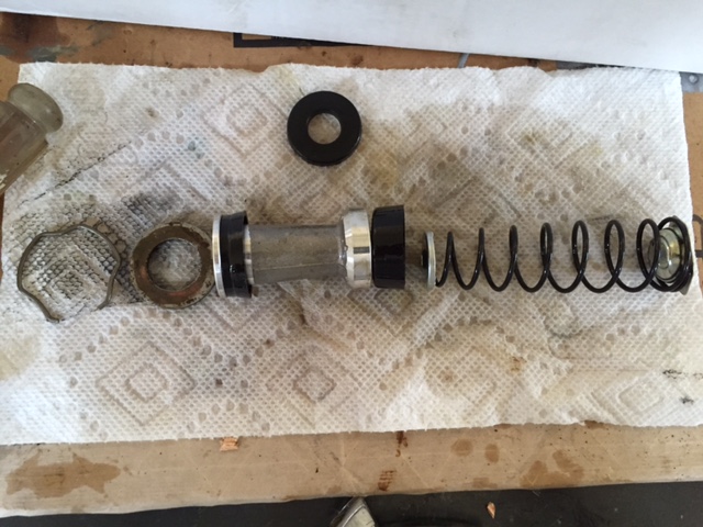

Regarding the MC rebuild. Since I have the kit I thought I would give it a go. Here is a photo of my rebuild parts lined-up in order of install into the bore. I'm not sure where the rubber washer goes (top of photo). I think it is the first thing that goes into the bore when reassembling. Any thoughts?

RMS
Posts: 930
Location: Richmond BC Canada
Re: Help with my brake problem
Post by RMS »
first in
rick3216
Posts: 18
Joined: Thu Mar 19, 2015 2:19 pm
Post by rick3216 »
Thanks. Is the valve positioned correctly with the radiused side of the valve inside of the spring? I'm referring to the second part that goes into the bore which is on the right side of the spring in the photo. I have it shown with the radiused side of the valve facing the spring and part of the valve being inside of the spring.
RMS
Posts: 930
Post by RMS »
the orientation of the residual pressure valve seems to be correct in your pic.
