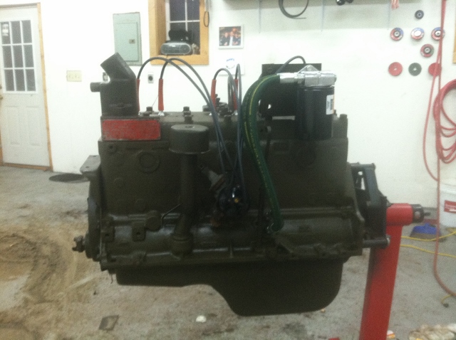

I have some good 251 performance info for you! I just finished building up a IND 251 last spring and I put it I my truck and the results were astounding compared to the 230!! I also needed more power but I wanted to stay with a flathead so what I ended up doing was getting a ind 251 (with a 8lug flywheel with 10 and 11' pp bolt patterns) and full flow oil filtration, I first balanced the rotating assembly and a full rebuild then I sent to camshaft out to delta camshaft in Tacoma Washington to have the cam reground to a 400m grind which is what they recommended for my application good tq and HP gain at a lower rpm max 4500, then I shaved the head .060 to bump compression, then I got civilian manifolds (higher rise intake and four bolt exhaust flange) then gasket match ported the maniflolds and block for good flow, it has hardened valve seats, sodium filled exhaust valves, I have the stock M37 carb on it with the governor removed and a good flowing exhaust
THE RESULTS
the truck is amazing now, sooooo much more power easily will tow your trailer, there is a hill in my town about 1.5 miles long and 8-10% grade with the old 230 engine I would hit the hill screaming at 45 at the bottom and by the top I would be still in 4th gear but only lugging at 20 mph now with the 251 I hit the hill at 45 and at the top Iam doing 43 that is a huge improvement my truck now even with the 5.83 gears will comfortably do 50-53 without the engine sounding like it is going to come unglued the tires are only 34" iam going to get some 38-39" tires then I figure I can cruze nice at 55-58, I would highly recommend the 251 or 265 swap the 265 is the same except it has a 1/4" more stroke which is great for tq but if not balanced you may have some revving issues over 2500, I figure that my engine is about 135 HP and 245TQ is my guess and I don't even have a header or 2 carbs so there is still a lot of room for improvement in the future I hope this helps! let me know I would be glad to help if you have any questions!
THE RESULTS
- PVT
- Posts: 33
- Joined: Fri Oct 05, 2012 7:06 am
Re: engine for towing with m37
251
- my 251
- IMG_0666 (640x478).jpg (167.6 KiB) Viewed 3749 times

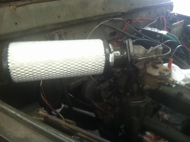

had to make this air filter setup because with the new higher rise intake the carb elbow hit the hood, plus this is way better filtration than the old oil bath
- IMG_0770 (640x478).jpg (167.7 KiB) Viewed 3749 times
must be sweet to drive with that 251! nothing like new and improved. the stock cams are made for 70 octane to now its set up for todays 89. the only disadvantage on the paper filter is now you don't have the elbow which is a protection against filling engine with water in fording situation. I read an SAE comparison study about oil bath v. paper and they both scored about the same. the oil bath will remove the finer particles than the paper but the paper can flow slightly more. so each has trade offs. same with the oil filter testing they did the full flow removes larger particles and the bypass will remove finer particle and will take the acidity out of the oil. on mopar truck 361 and 413-4 engines they had both bypass and full flow oil filtration. that would be ideal.justindearb wrote:had to make this air filter setup because with the new higher rise intake the carb elbow hit the hood, plus this is way better filtration than the old oil bath
