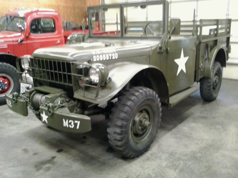

When I sanded my truck (52 Army M37) I found the tailgate star on the right side. It's going back there I think,
but have seen them on the left and one on each side.
So beings mine was originally on the right seems it should go back there.
Now on the front split winch bumper I found no Star or unit markings.
Which side dose the star usually go? And closer to the center or ends?
Thanks
TGP

Ok in researching the TM"s Looks like the national symbol should be placed in or near the center front, back and top. or close as.

No star on front bumpers of winch equipped trucks.

Thanks Rick.
We got one now left center.
I guess I will have to remove it, although I'm not 100% correct and saw a few others in various pictures.

They was lots of variation over time and across units. The thing to keep in mind is that there is not "one correct way".
The doors and hood are pretty standard. However, if you have a B1 there is a star in front of the driver's door, not on the driver's door.
There are usually, but not always, two stars on the tailgate. Usually there are no stars on the front bumper of winch trucks. Usually there are no stars on the side of the bed (I have seen pictures of trucks in VN with small stars on the side of the bed).
So, there is "guidance" but no "one size fits all".

Never say never. I have a whole lot of period pictures from units in the U.S., Europe, Korea, and Vietnam of M37's with winches sporting stars on the front bumper. It looks like it varied from unit to unit but there are way too many pictures showing winch trucks with stars on the bumper to say "no star". I'll post a variety of the better pics when I get a chance in the next couple of days.milstencil wrote:No star on front bumpers of winch equipped trucks.
Rick
Even my truck has it's original vinyl star on the front bumper. The markings on my truck were never scrubbed when it was released from service, they're all original as the unit applied them sometime in the 1960's.
