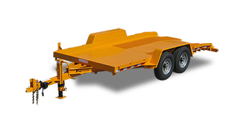

Hey Crew.
You Guys always amaze me with your advice and willingness to help. Last night at about 02:00 my Lori and I had a long talk about what this trailer might been used for besides the "M". I own a 6K forktruck. A Taylor-Dunn electric utility cart. A 20 hp Wheel-Horse with mower deck & 2 stage snowblower. My Military air-cary. Too many toys yet?????????? Anyway some of these units don't like ramps! I've turned my attention to a tilt skid-loader or forklift trailer. Full tilt no stationary part of the forward bed. I also do not want any type of dove/beaver-tail. I simply don't like them. (It's a trucker thing) I'll keep looking, I've got more time than money! The right trailer will find me!
I see someone had posted abut a tow-bar. My Lori has already ruled that option out! (I'm really the boss around here. :oops: )
This one would be perfect!
