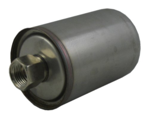

Does anyone have a recommendation for an inline fuel filter and location?
I'd prefer one that had fittings for flare nuts at both ends and connected between the fuel pump and the flex hose.

Re: Inline fuel filter recomendation
JB,
I'm referring to the hose that goes from fuel cutoff hard line up to the top of the fuel pump, the replacement part is Eaton Weatherhead 11078 and has brass fittings at both ends.
I have had a clear plastic filter between the fuel pump and carb but I would rather have a more polished solution, I was hoping a filter like the one below would work in the same spot but without the rubber hoses.
I ended up using an ACDelco GF652 inline fuel filter between the fuel pump and carb.
Racer,
Thats a nice clean install. I like it.
Brett
Brett
Nice installation Racer. Looks professional and to the un-trained eye, looks stock.
What could be better!
Good job.
JB
I agree, looks uncluttered and trim! I thought I saw some Teflon tape on some connections, but not all of them (supply), was there a reason for that?
I didnt use any thread sealant on the fuel lines, all the connections use compression fittings.
Ahhhh I see what you are saying, the fitting coming out of the top of the fuel pump is a standard pipe fitting at one end and compression at the other so some thread sealant was used on the fuel pump side.
Not a big deal, I just wanted to clarify it. I did use it, then re-installed w/o the tape.
