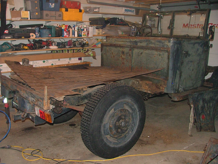

Reproduction bed going in.

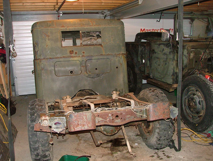

Parts truck on left, running truck right

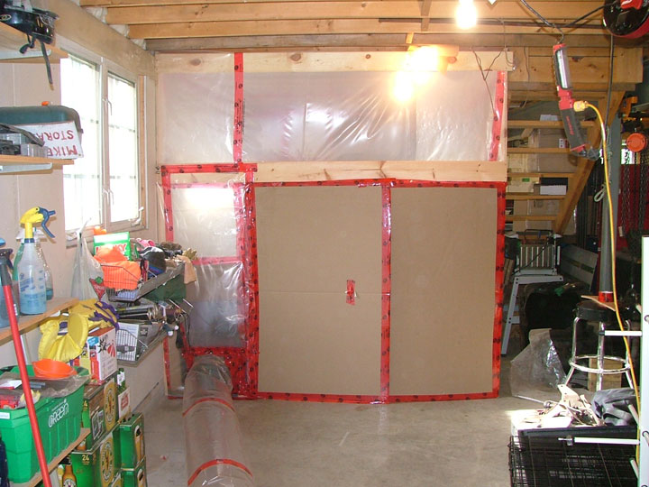

my 40.00 paint booth

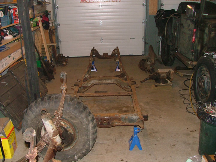

frame stripped ready for blasting

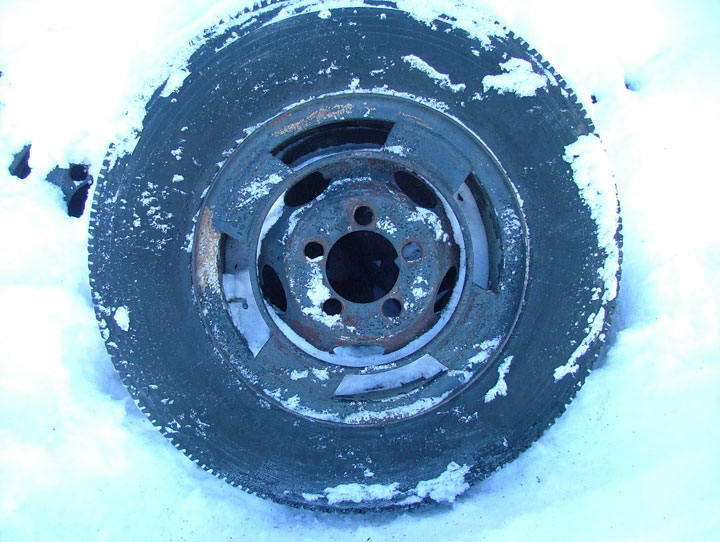

Can I get a close-up picture of the rims on that truck? I didn't realize CDN trucks had (what appear to be) different rims?

The rims looked to me to be a complete 16" Budd wheel welded into a 20" wheel, is that what they are?

That's correct… 16'' Budd wheel welded into 20'' wheel.
I am going back to original 16'' Budd wheels and got a few mounted up this weekend.
The split rings were NOS so once I offset the ends a bit by standing on the one side and gently pulling up on the other they went in easy, only boot power required.
This would only have to be done with new rings as once used they have that offset anyway.
I put the split in the ring opposite the air value as I heard that this helps with balancing, seems to make sense.
I ran electrical tape around the top edge of the ring to prevent chipping, only minor touch up on the wheels required.

16'' Budd wheel welded in 20'' wheel
