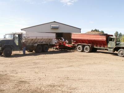

After just getting done with potato harvest, I am a firm believer in the XL's. Of course I am running the M-800 series of 10 wheelers. We put about 46,000 GVW on these trucks and run them through at least a foot of mud. I have a 900 series truck with the newer tire tread and they would clog with mud. The XL's were unbelieveable what they would go through.
We did get stuck a couple of times, but if you only bottom out on the diffs and the axles, they were not that hard to pull out.
- Harvest 2011 -1.jpg (60.98 KiB) Viewed 3072 times
