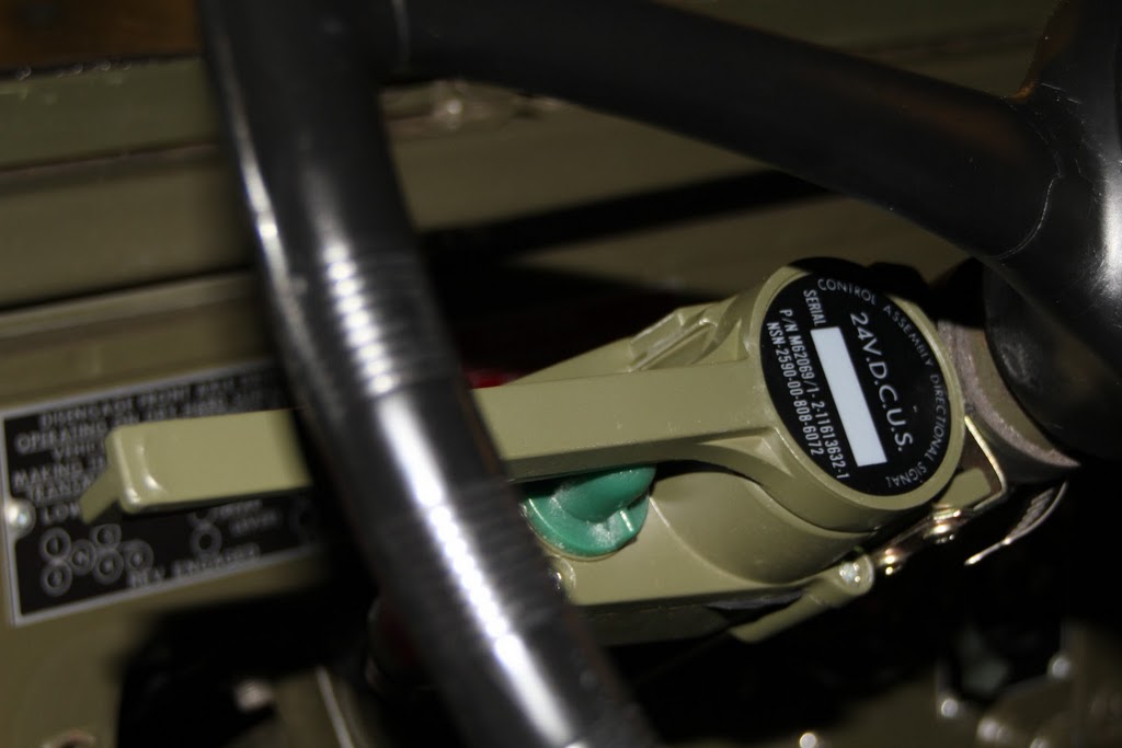

M37UK
Posts: 460
Re: Signal Stat 600
Post by M37UK »
MSeriesRebuild wrote:
M37UK wrote:I have wired the switch to a modern 24v LED friendly electronic flasher unit and wired all the flasher lamps myself. I didnt see the point in using the transistorised box. We have slighly different rules over here about flashing lamps
so I cannot have the brake lights flashing at the same time etc.
Cheers
"well that's the beauty of a 900 series switch, all that is done within the switch to separate the brake light function from the signal function, makes it really simple and works great for the long haul."
I only had to connect 4 wires from my switch, cant get much simpler than that! :D
Stu
MVT UK
SMVG Scotland
MSeriesRebuild
Posts: 2832
Location: Norwood, NC
Re: Signal Stat 600
Post by MSeriesRebuild »
That switch you have pictured is the military version of the 900 series. Unless it had been altered, there would be 7-wires coming from it.
powerwagontim
Posts: 744
Re: Signal Stat 600
Post by powerwagontim »
Hi Charles,
Of the 7 wires, 3 plug directly into the flasher, leaving the 4 that Stu was referring to.
Tim
