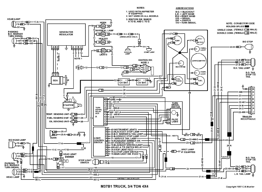

Also, what manual/where could we find the wiring schematic for this?

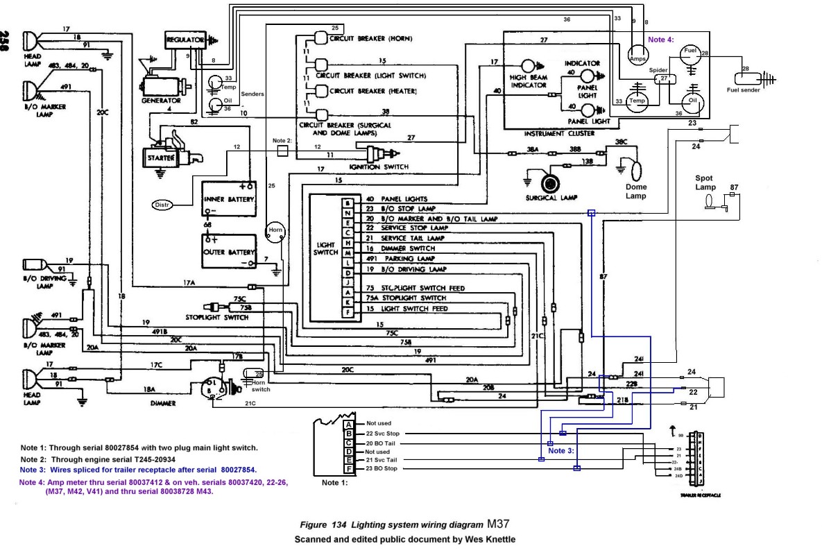

Wes on the job again! I recalled this schematic in an old post, and I beleive Wes being the postmaster on that one too....

Re: WTB M-37 rear diff, and wiring info
Many thx my friends, that is the right diagram i needed, and now back to bringing another old milly truck to life
Thanks for that! I was looking all over for the wiring diagram that was printable. Everything you find on google is way to small to see the labels.
