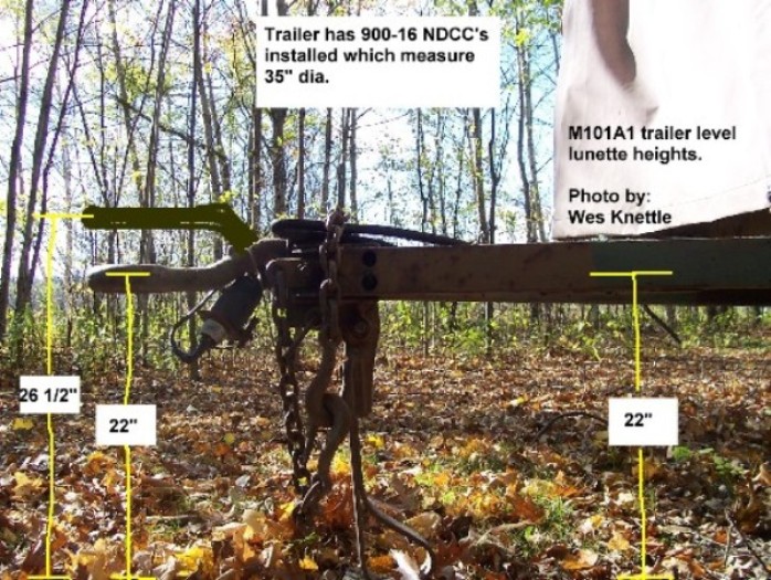

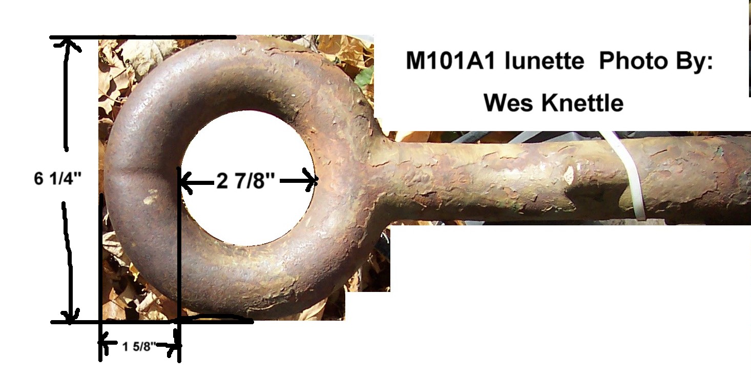

The measurements for the M101 and M101A1 are:
Heights are:

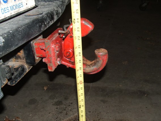

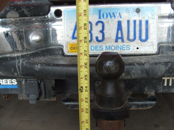

Here are a couple of shots of my ball-mount we use to pull the boat. Sorry about the dirty truck, it's usually not that dirty, we just got home last night. The only reason I'm looking at the adapter from Wallace Forge is I'm trying to save a few dollars. I've got a pintle hitch but it comes straight out of the receiver hitch with no rise.
THANK YOU ALL for all the pictures and help. Once this trailer gets home it will be strictly for the "M". I have other trailers for hauling!

I would just use the pintle hook you already have have. It should work fine. I don't think you will have any problems getting it home with it riding a couple of inches lower at the tongue. I would choose that over the adapter setup.

Looks like your receiver is just about the same 22" in my measurements. So you should have no problem pulling that M101 home. Take a stout bar like a heavy old jack handle and a 3/4" socket set along with a heavy hammer and some PB Blaster with you so you can rotate the two position lunette if need be.

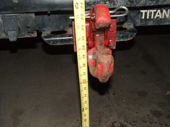

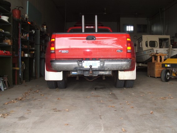

Again with the dirty rig. I am embarrassed! OK, that said, here is my pintle hitch sitting in the receiver. As far as lights I have a set of towing lights I'll use to get it home.

Looks like only a 2 or 3" down pitch on the drawbar for the trailer. Should tow just fine.
