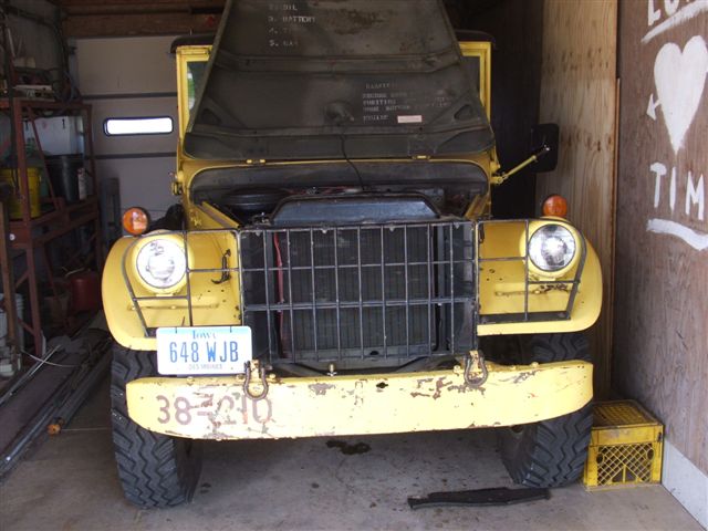

Heres a shot of the front of Lori's "M" so you can see the front lamps I need. I hate those lights on the fenders!! Hammer time!
- Original lamps and brackets needed!

The lights and brackets posted by Cordell are the type you need for Lori's M. One blackout headlight for the left side and two parking/ turn signal/ blackout markers, one for each side. Here is a shot of the left side lights on my truck.

Tim, On the two blackout lights, you want the Yellow one for the M37 as the other pictured is for a M151. I dont know if your going to restore it to its stock look or what but you can also use the later composit lights but you still need his brackets. My personal opinion is go for the "Cats Eyes".

You need the Yellow Blackout light and it goes with the bracket on the left. The Red light is a "Cats Eye" style lens because of the upper shape of the light. It goes with the bracket on the right. From what I see you will need one more "Cats Eye" light and the bracket that goes with it. Now when you find another one, if you get these pictured, make sure your other is a Clear Lens as they also have ones that are yellow lenses. The clear lenses are what you would see when the truck was built in 1951-53. You should start a Post on your project!
