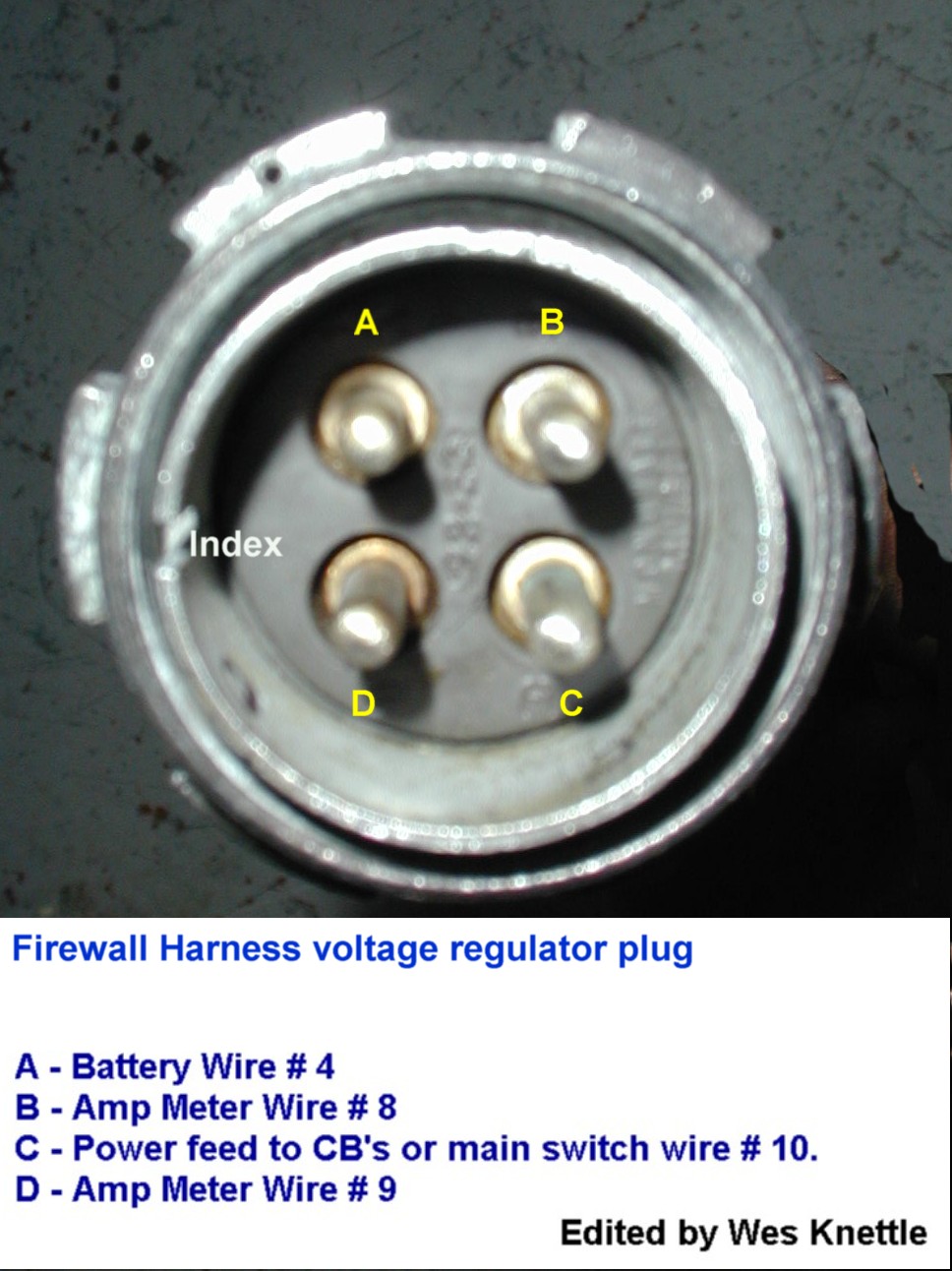

No it won't hurt anything for a little neighborhood cruising until the parts get back. You'll need to make arrangements for power to the ignition and gauges while the regulator is unplugged. Wire # 10 needs the juice from wire # 4 in that plug so you'll need to install a jumper from pin A to Pin C using a pair of female pin sockets that fit the male pins in the plug and a short piece of 12 or 10 gauge wire and some solder. Then tie the plug end up tight.
Have you determined what fried the regulator? Have you had the generator bench checked yet? When the fellow finishes the regulator repair I would urge you to take the generator to him and have him set the two up together on the bench so you'll have less putzing to do when you put them back on.
FW harness VR Plug.JPG (210.81 KiB) Viewed 1283 times
