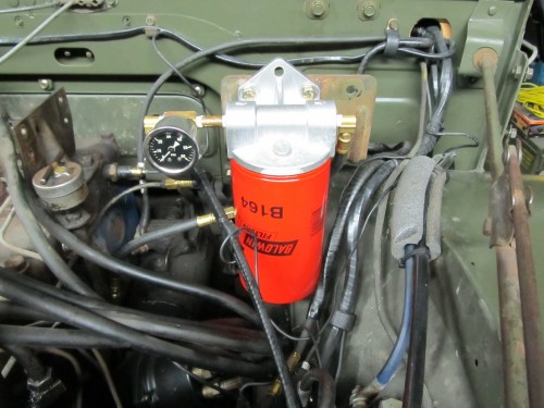

- milstencil
- CPL
- Posts: 169
- Location: Snowy MA
Re: Oil Filter Conversion?
LH7,
I just finished the filter upgrade.
I'll try and attach a photo.
Are you sure you have the right filter base?
The filter system is a bypass type of system and requires a filter and base
just for that.
The Baldwin number OB1305 for the base and the filter is B-164.
Is the number you have a NAPA number.
I used 2 - 1/4" inverted flare x 1/8"NPT fittings as I moved the filter to the
regulator bracket.
Any parts store that sells metal brake lines should have the fittings.
Rick
just for that.
regulator bracket.
Rick
- M37 oil filter.jpg (54.14 KiB) Viewed 2183 times
