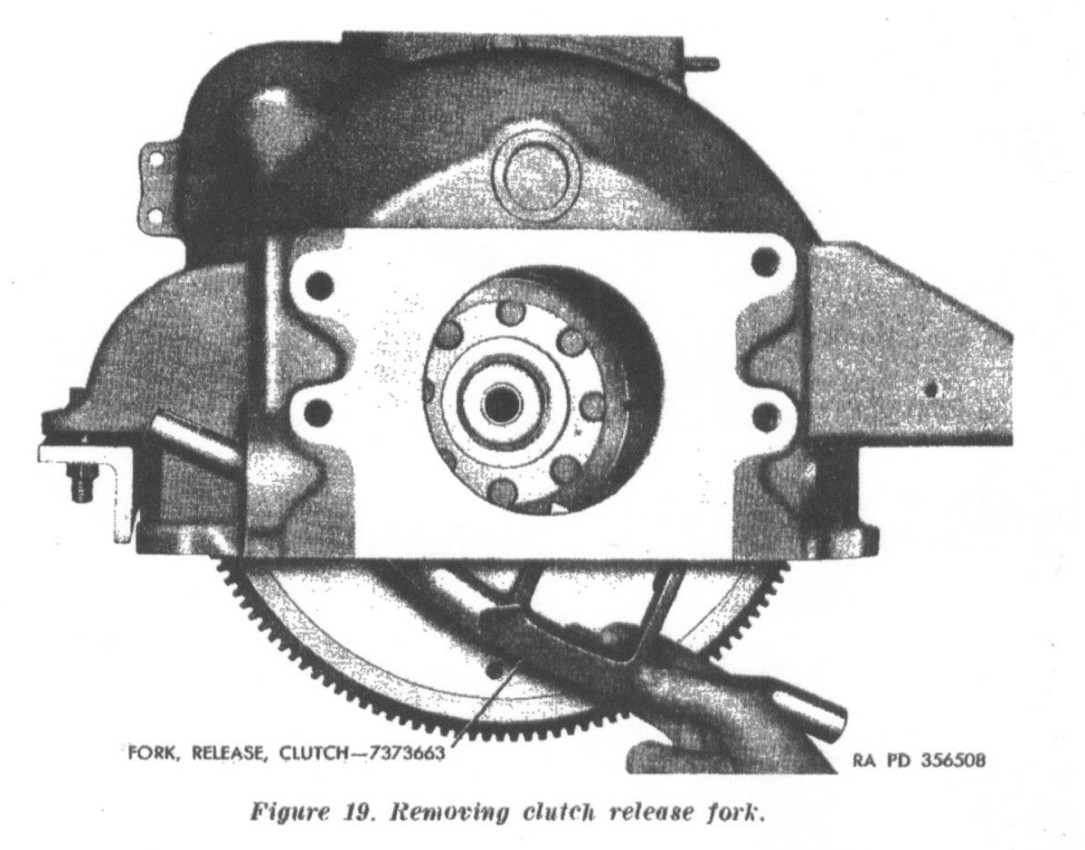

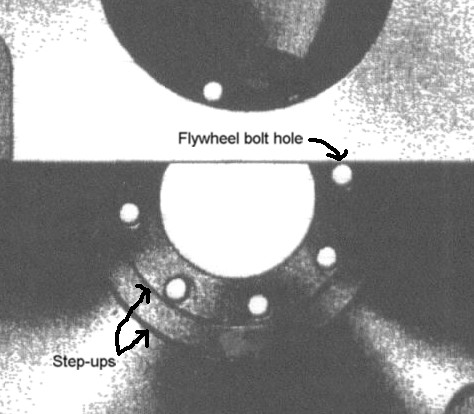

Re: Flywheel bolts
Hello Lifer,
The original bolts heads were accurately sized to wedge against the first step up of the flywheel at the hub and at the same time clear the clutch hub. To use a generic fat headed Grade 8 bolt one would have to mill at least one flat so it fits snugly against the step up in the flywheel and mill the head down enough so it can't hit anything above it.
Fug 58 detail.JPG (44.42 KiB) Viewed 2126 times
Fig 19 sm.JPG (148.46 KiB) Viewed 2126 times
