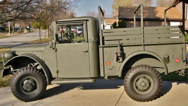

Here is a picture of my rack before I painted the truck. I hope this helps!

- ALMOST DONE!.jpg (94.05 KiB) Viewed 2587 times

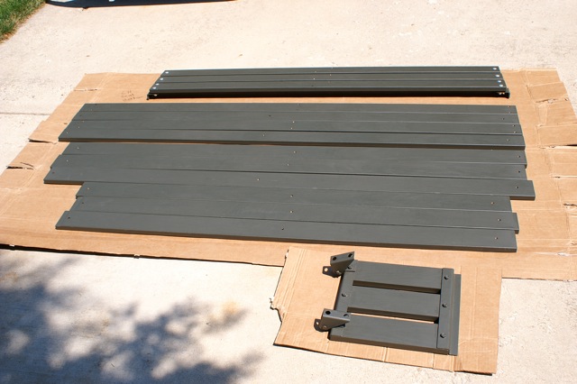

Here is the rack ready to be installed, all painted and pretty!

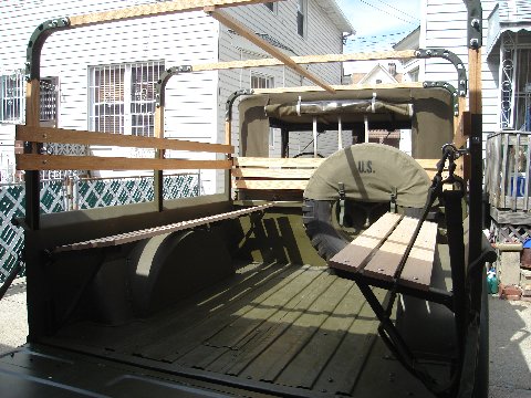

I just couldn't bring myself to paint all that nice Red Oak Green,
So I polyurethaned it..

Nice pix Guys!
- Posts: 1822
Re: Headache Rack headache
Nice pictures, guys.
Sal,
I like the tire cover for the spare, I was thinking of doing the same thing.
Sal,
I got it from New Life Canvas. They do really nice work over there...
Sal
