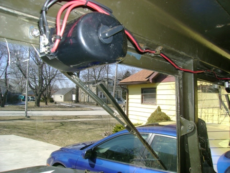

And Maybe Newer! The old ones where vacume, New are Eletric but just Don't make it ! no reel sweep from these less then "American" product , I'm hopping that 1 of us has gone this route and found a Good Old non Slope Head ! Wippers that are electric and still Keep the Some What Naturel Look ! :wink: Note picture below . Please Help! :idea:

Check out the ones we use on our rebuilt trucks at our website.

You could also search through some of the hot rod magazines, they often have cable drive wiper setups that appear to be unobtrusive, yet have good performance. Would a vacume resevoir help the original wipers?

With new or properly overhauled vacuum wiper motors, a properly overhauled dual fuel/vacuum pump, a properly running & healthy engine and proper plumbing and hoses the system is very capable. A reservoir would help a weak system. The cost of renovating a vacuum wiper system, buying modern Army 24 volt electric motors or buying 24 volt after market electric motors is all about the same. A lot will depend on how stock the builder wants his truck and if a re-engined truck, how fast he intends to drive it in the rain.

Check out marine supply stores. They have different grades of wipers in 12, 24, and 32 dc volts. they come in one or two speed, self parking, etc. Take a look at there web sitesI'm sure you will find a top of the line wiper motor.

The only advantage to installing a vacuum reservoir would be that it will "even out" the operation of the wipers. There's nothing more irritating than to be driving down a hilly road in a downpour. The wipers literally "run away with themselves" on the downhill run and come to a dead stop when you drop the hammer for the uphill pull if you're running them off a manifold vacuum tap. The vacuum/fuel pump was intended to eliminate that problem, and it does...to an extent. However, when the rpm drops far enough, they will bog down a bit. The longer the hill, the longer you will be "driving on instruments." Just one of the many enjoyable aspects of living with "low tech" mechanicals. ;)

Are you running your 24V wipers on 12V? I had 24V ones in mine, running on 12 when I converted to teh V8 and they were VERY slow.

12v civi, Looking into some reel Wippers Motors thru M Series Rebuild.

Picture's of wiper up grade and some other things I'v been up to Can't seem to get them on here so check out my pictures on the truck on this site, File Is Called "M 37 up dates". 8) .
