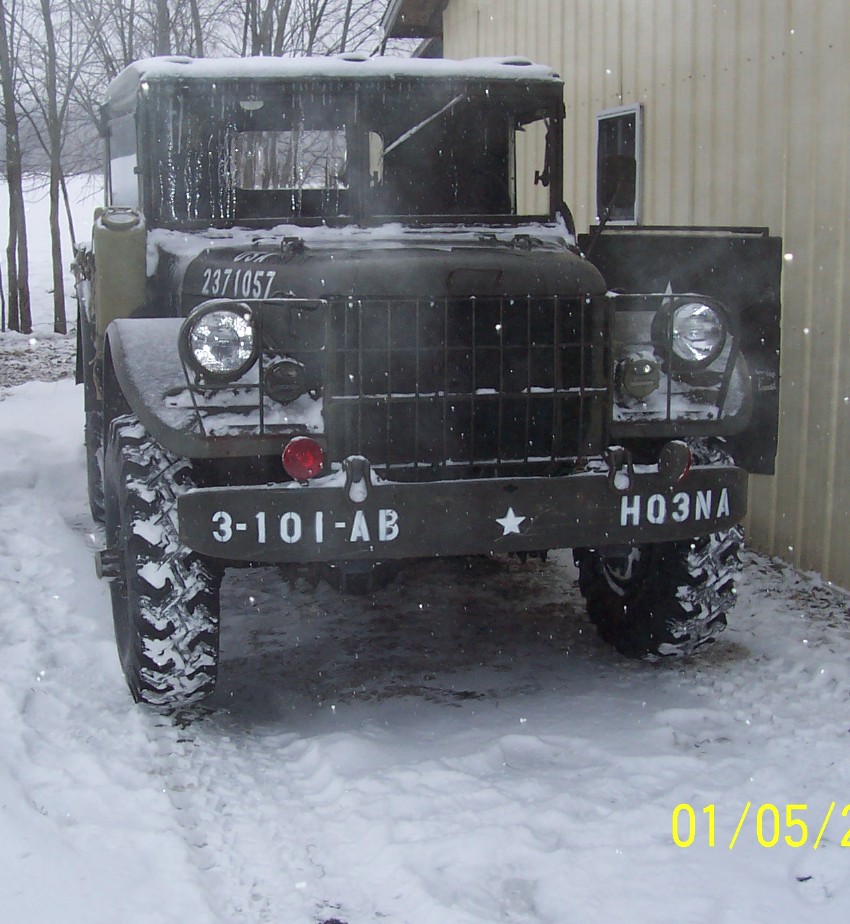

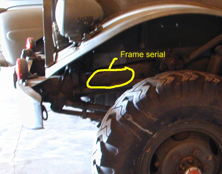

Or should I be looking for better tires and what would you recommend.
These tires have handled over 20" of snow this winter with no problems pulling round bales.
Have these on our WM300 Power wagons at work, I LOVE them. Our trucks don't go out in the winter, but I have done my fair share of heavy off road driving with them (they are firetrucks) and always loved the performence of the tires.
My '52 M37 came with what appears to be the firestone version, they seems pretty decent (unfortunately mine are VERY dry rotted)
