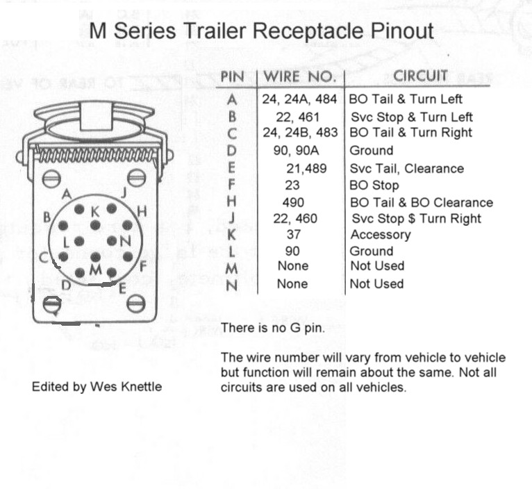

Re: Sid Beck's Greek wiring harnesses?
The plugs were wired differently on different vehicles. Here's a generic pinout that should help.
Trlr Plug Pinout.JPG (95.61 KiB) Viewed 3275 times

No, he didnt send me anything, but another kind soul sent me a copy. I had been under the mistaken impression that the harnesses had provisions for turn signals, thats what threw me whan I seemed to be coming up short on wires.

It will take me a little while but I have the drawings from Sid. I had scans of them on my computer but had to reformat last November. SO I will do'em again. It is only the blue wire and the brown wire between the front and rear harness that are not correct the rest were as they should be. For the blinkers you will need to add a wire for power to J on the back of the main light switch plug. Same on the trailer plug Check out Cuz above for a great drawing of the plug and wires.
